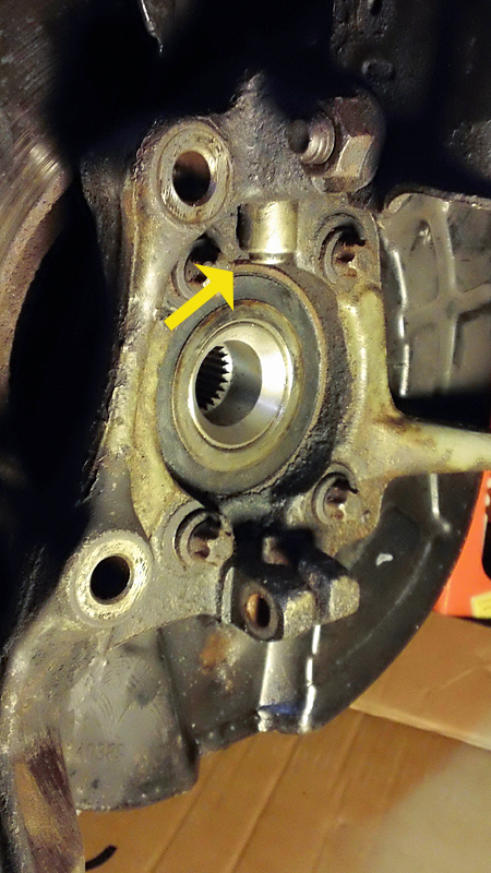

...i am not able to loosen the ABS Sensor, and remove it.
The #14 torx bolts are few turn loose, waiting to come out. BUT...
Haynes Manual - 10-4 Removal 8. I quote, "Check whether the position of the brake disc in relation to the hub is marked, and if not, make your own mark as an aid to installation."
Where to look, and what to mark? I will install new hub assembly.

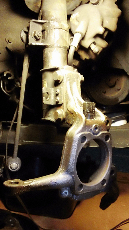

Diver's side hub assembly condition is making the torx 14 not move at all. Added more PB blaster for the second day.
Now postponing it to coming weekend.

You can always try heat as well; MAP gas or propane torches really help! When I did mine, the bolts came out ok (with a bit of heat), but it was 'glued' to the knuckle, a few whacks with a rubber mallet might help you in removing the 4 bolts, and the hub itself..

If you decide to use heat (Propane torch is $10 at hardware store, same stuff plumbers use to solder copper pipes), don't heat the bolt head itself but rather heat the bearing side to expand the steel.
Have a look at the bearing mount (where it mounts into the knuckle), and you will see where the Torx bolts go into, there is where you want to apply heat.
Make sure you don't heat the ABS sensor!

Your problem is the main reason I leave the steering knuckle on the control arm to remove the hub bolts. As you know from doing one side already the bolts fight like hell until the loc-tite snaps and having the control arm there to hold things in place gives you something to wrench against. Once the bolts break free you can almost remove them with your fingers.

You are right Lee, since suspended with struts only it swings. I will put the control arm back on loosely, add little heat. Would it catch fire since it is soaked with PB Blaster?Ozark Lee wrote:Your problem is the main reason I leave the steering knuckle on the control arm to remove the hub bolts. As you know from doing one side already the bolts fight like hell until the loc-tite snaps and having the control arm there to hold things in place gives you something to wrench against. Once the bolts break free you can almost remove them with your fingers.
...Lee
During the moment of loosing fight, I started to look closely at the bearing, it is original Volvo. It has same numerals as on the new replacement timken/fag. Never replaced I assume.
