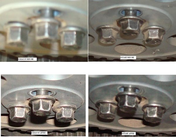

Photo:

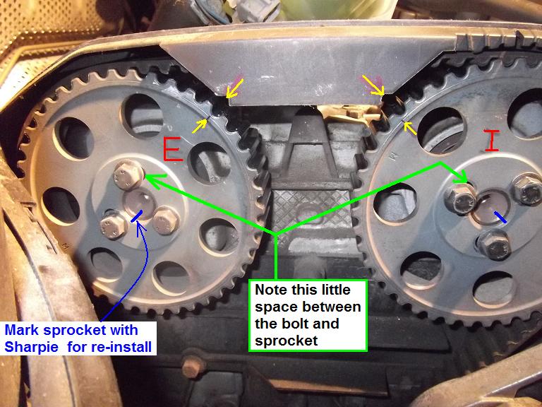

This is my current cam setup, note that BOTH sprockets are in retarded position.

Hmmm interesting. Here's some food for thought:
42 teeth per cam gear (did I count right?)
so (360 degrees) / (42 teeth) = 8.57 degrees per tooth.
The amount of adjustment on the cam slots is 15 degrees, ±7.5 if the bolts were in the center when it left the factory (I know, that is arbitrary and maybe they weren't). So if you now rotated the cams so both sprockets went all the way the other direction, you should be moving them exactly 1.75 teeth, yes! But back to the middle would be just under one tooth (7/8 of a tooth).
So in the picture up there of your engine, I can see the cams are not yet in the timing position (they are a little cockeyed) - is the crank not on the mark even though the sprockets are? In that case, when you do put the crank on the mark, how far off are the cam marks? If the crank is in fact on the mark, then how far off are the cam marks when the triangles are in the home position?
In other words, how many teeth is it off right now, just by observation? Would adjusting the cams back make it better, or worse?
Posts: 8359
Joined: 31 Mar 2010, 09:54
Year and Model: 2004 V70 2.5T
Location: Omaha NE
Been thanked: 504 times
Post by cn90 »
erikv11,
You are correct, about 8.57 degrees/tooth.
Actually this is it:
The Cam timing marks are on (it depends on the angle of the camera)
The Crank mark is on.
I did all these cam adjustments AFTER the cam seals were replaced, but BEFORE the TB was installed.
Car runs just fine, so I am planning on leaving it alone.
