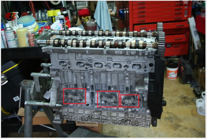

I once had a leak that was hard to find. I had to clean everything up and get under the car with it running to find the leak (ramps). There are some plates on the back of the motor that has a thin gasket which was leaking. The gasket kit was something like $7 at the stealer and took me 20 minutes to change (I'm a slow worker).

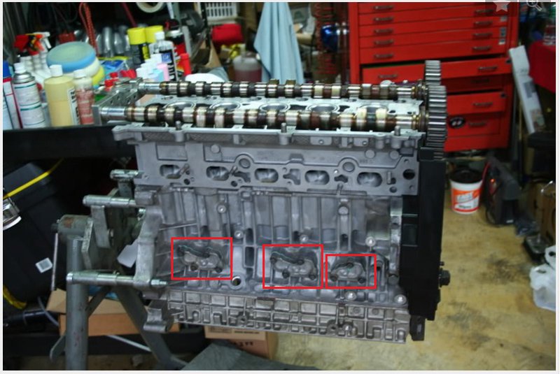

My 1998 S70 GLT with 185K miles has now developed a leak exactly like in the photo posted above by rspi.
Can someone post the PN for these 3 gaskets?
I borrowed this photo from the internet to show you the 3 gaskets I need to buy:
Thanks!
Thanks!

Wow that is bad luck, very rare location for a leak, prior to this I would have guessed only the abused engines picked up a leak there. Surprising. One thing to consider, many people just use the standard anaerobic sealant that you probably already have in the garage.
http://volvospeed.com/vs_forum/topic/16 ... s-gaskets/
