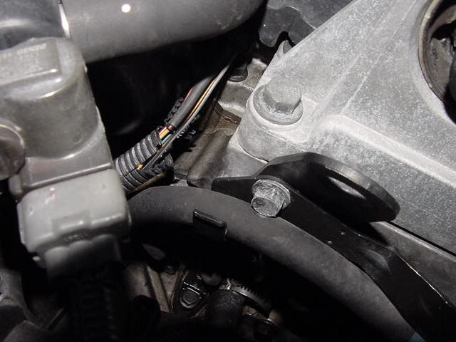

I misspoke when I used the word cap. I was referring to the cover for the cam seal. There still seems to be oil running down from that cover.
- MVC-023S.JPG (36.71 KiB) Viewed 679 times
- MVC-024S.JPG (36.85 KiB) Viewed 679 times

Aha, then do see my striked out text above, i.e. could also be
3. not installed properly (is it straight/flat? flush with the outer surface?)
4. the seal was nicked or bent before installation
or even
5. some people find that surrounding the seal with a thin layer of silicone is necessary to get a good seal.
You're going to want to pull that cover and look at the seal; can you tell where the leak is coming from (or, as cn90 suggested in #1, is it really leaking at all?)?
or even

Each cam has a rear seal and a front seal. They are different sizes. And there are two cams right, so altogether four seals. But if only one is leaking (the rear on the intake cam in your pics), then I would probably only replace that one. Your call, the rears don't take a lot of effort but I don't like to replace a part that isn't bad. Can become an expensive habit.
FWIW some people will swear that it is fine to push those seals all the way in so it may be, but I am certain they come from the factory flush.
Be sure to gently clean the bare surface of the cam from any buildup, that can also cause the seal to not work properly.

On my '99 there wasn't even a seal there behind the cap on the intake cam and I tore the cap up pretty good getting it off. It appeared that there never was a seal installed. I don't know how they think you can get the old cap off without killing it.
I installed a seal and bought a new cover cap and no leaks.
...Lee
