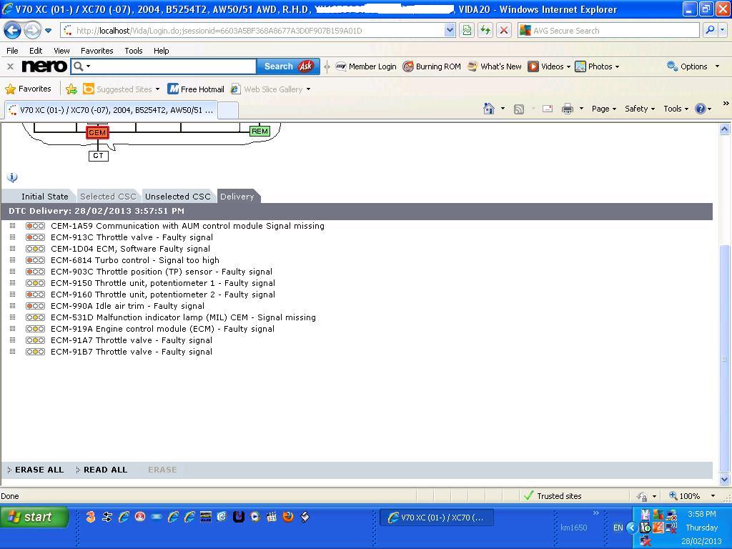

This is the list of codes. I was able to remove all of them (except the AUM audio module code) by cleaning the ECM connector. It's been 3 weeks now and I haven't heard from the customer.
- Pic2 Post TB.JPG (111.06 KiB) Viewed 1763 times

The common denominator is that whenever someone (you, indie, dealer) is near the pins on the ETB you get a driveable car that shortly thereafter develops the same issue. I think this speaks to a simple connector problem that needs to be resolved.
Once the reliability of the electronics is compromised, the codes are of limited utility IMHO. Rough running will cause all sorts of codes to be thrown - none of which may be relevant.
