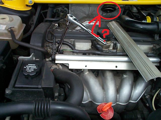

sensor?

Pretty sure that's the alarm horn.. lol

which never has worked on my 95 850. when i manually trip alarm, only the hazards blink on/off. no horn.
tried to adjust horn nut, no help. R2 horn, no help. R2 relay, no help. im not chasing wiring circuits. thank goodness no one around here wants to steal my volvo!

I know mine had the same situation and I loosened the nut and ran the center piece all the way in, tightened down the nut and backed out a half a turn and it did work. I believe it was either Mr. Blackburn or Lee that made the suggestion.
