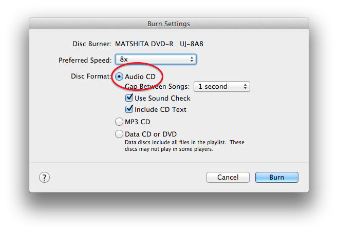

Erik, I believe the burn format should be simply "audio CD" or whatever the software calls it.
I don't have a problem when I use this iTunes setting:
Also, in the old days of ~2000-2001, certain brands of CD-recordable discs would work in my 850 (SC-816), and some would not. I don't remember what the distinction was... perhaps 74 minutes vs. 80 minutes capacity.
http://en.wikipedia.org/wiki/WAVAudio CDs do not use WAV as their sound format, using instead Red Book audio. The commonality is that both audio CDs and WAV files have the audio data encoded in PCM. WAV is a data file format for a computer to use that cannot be understood by CD players directly. To record WAV files to an Audio CD the file headers must be stripped and the remaining PCM data written directly to the disc as individual tracks with zero-padding added to match the CD's sector size. In order for a WAV file to be able to be burned to a CD, it should be in the 44100 Hz, 16-bit stereo format.
