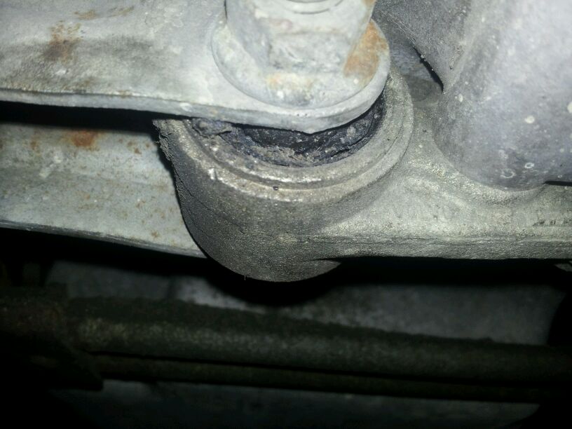

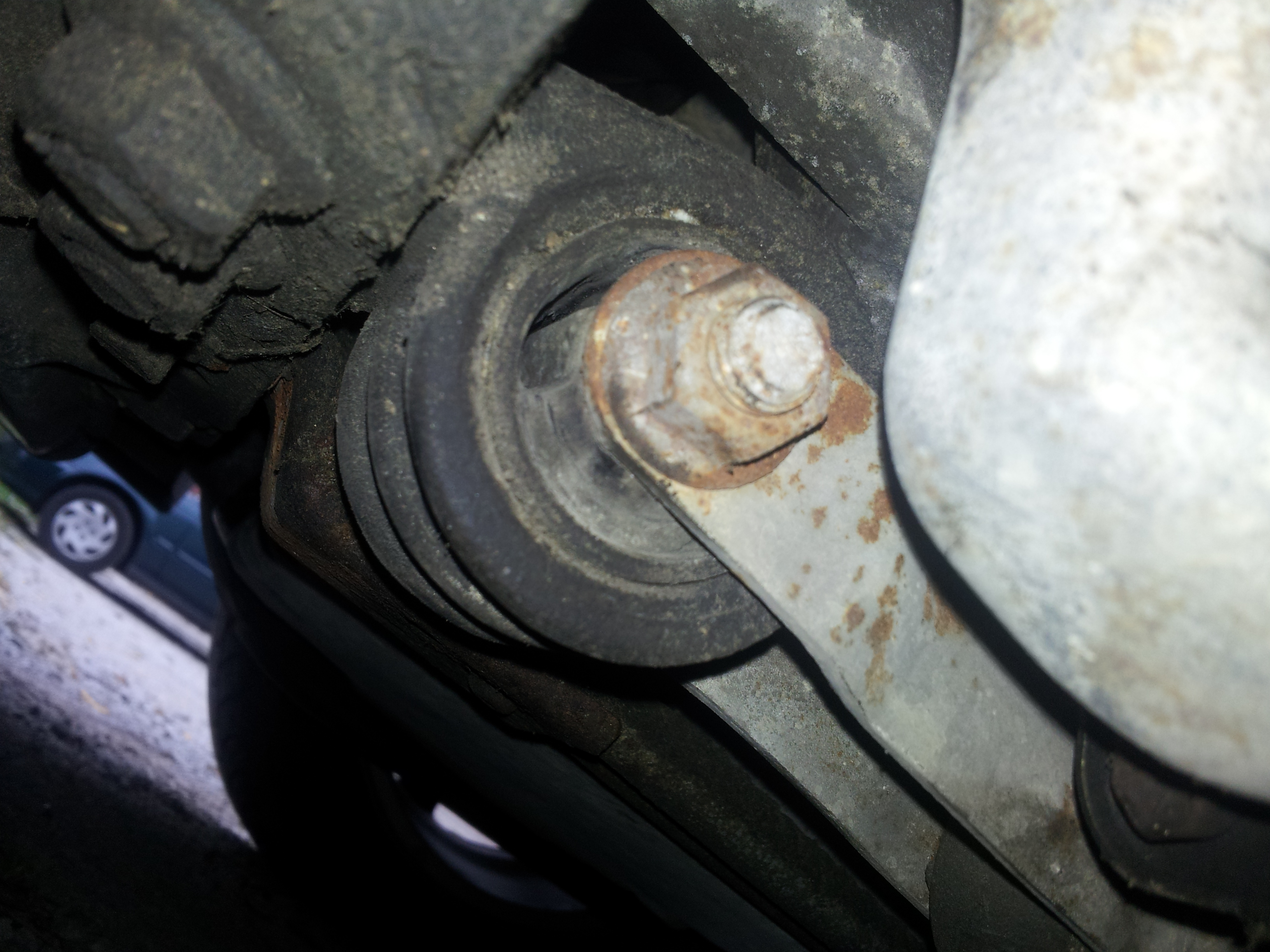

So I just checked the transmission torque mount and it appears to be pretty worn out. There is a sizable hole in the bushing toward the front of the car.

dghost wrote:So I just checked the transmission torque mount and it appears to be pretty worn out. There is a sizable hole in the bushing toward the front of the car.
Check all the other engine mounts and if after changing the mount(s) and the shifting is still problematic I would do a drain and fill first as it only has 9K miles since the flush. Use the Lucas Trans-fluid and it improves or eliminates any remaining issues then the Transmission Fluid should be flushed again as not all Trans-fluids are made the same. The reason for the drain and fill is to test what maybe causing the issue(s). The S70 transmission is so stout it compensates for the various quality of fluids.

Looks like it needs to be replaced?
