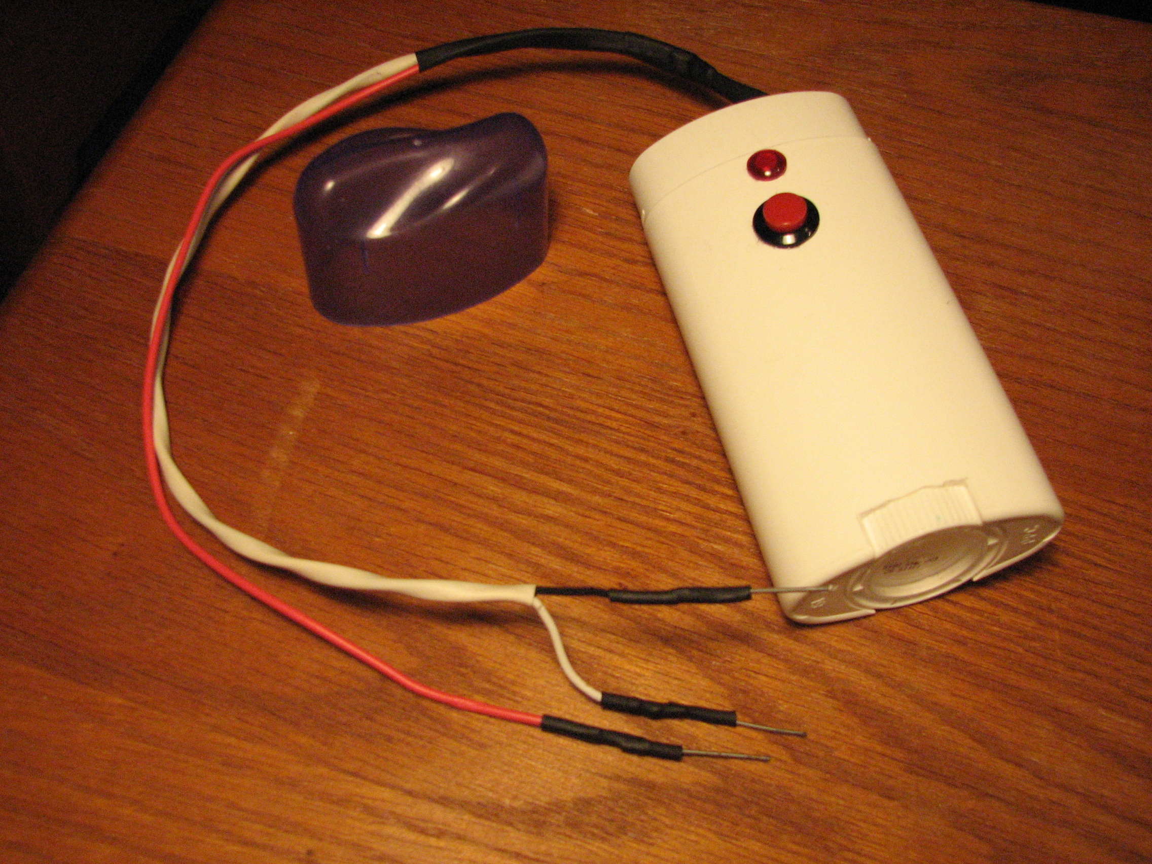

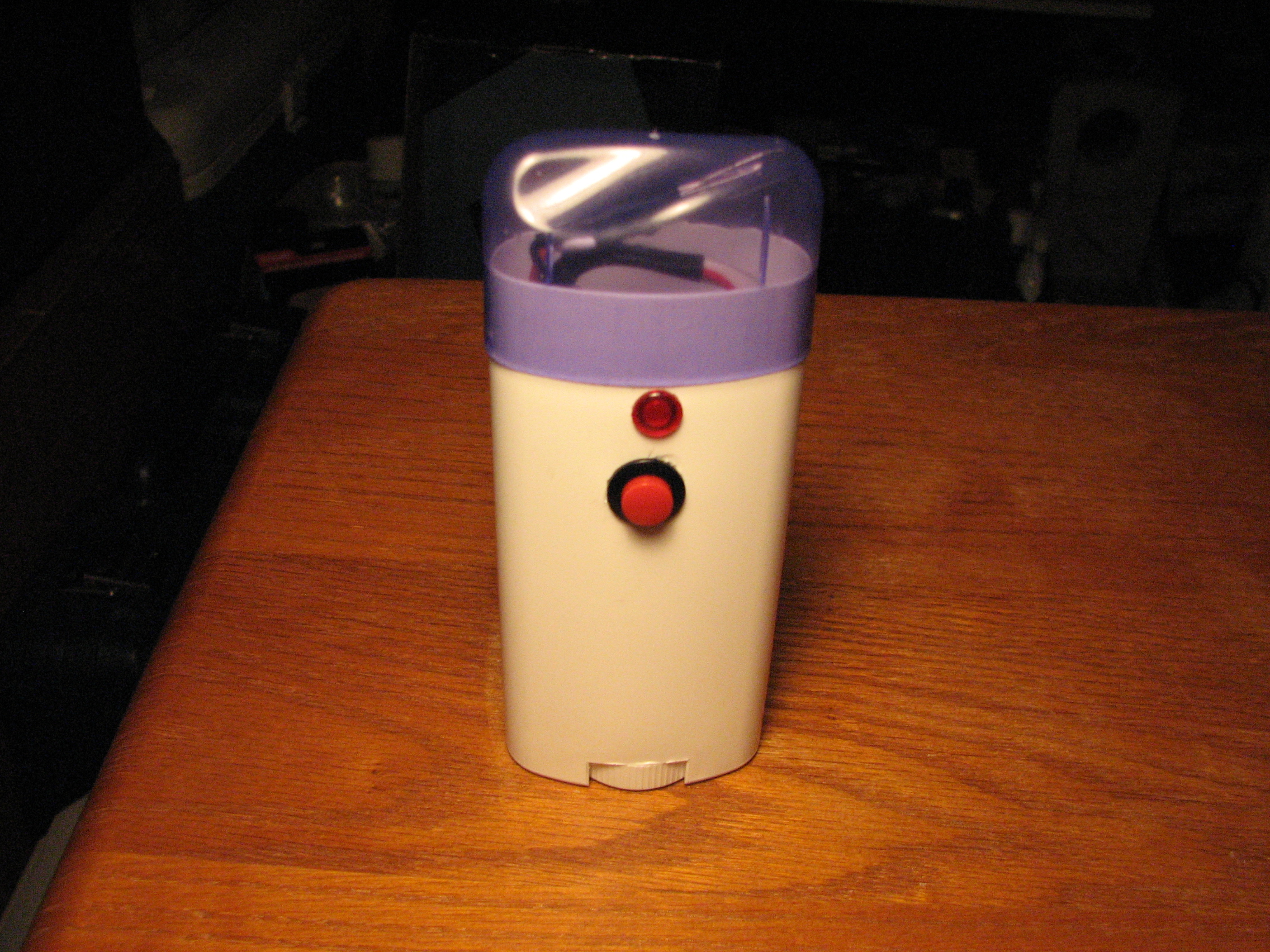

So after reading a few threads I built my own LED flash code reader from the simplest schematic imaginable. I was a little bored and got creative with it. I built a reusable tool that stores cleanly and untangled.
I thought of ease of operation, self contained and conveniently storable. I was inspired by looking around for something to repurpose.
The next photos should be self explanatory.

What does this do above and beyond OBD2? If your ECC would power up, would it be able to flash the ECC codes. eg 1-1-1, 2-2-1 etc for troubleshooting ECC blinky lights? I've got a 98 V70 that blinks its ECC lights at turn on time. Still works but I know something is wrong.

It reads the specific trouble codes as in the 1-1-1 style of the OBD I under the hood used in '93 to '95 850. Not the blinking you get on your actual ECC unit in the dash, which only lets you know something is wrong.rmmagow wrote:What does this do above and beyond OBD2? If your ECC would power up, would it be able to flash the ECC codes. eg 1-1-1, 2-2-1 etc for troubleshooting ECC blinky lights? I've got a 98 V70 that blinks its ECC lights at turn on time. Still works but I know something is wrong.

What happens if you rotate the little dial at the bottom?

"What happens if you rotate the little dial at the bottom?"
It does the same thing as my present ECC unit.

You can mount it in the ECC slot until you get that one sorted out!

...the small dial will cover up the smell of the driver...

You know too much about me!abscate wrote:...the small dial will cover up the smell of the driver...
I have given some thought to this thing I have found.
