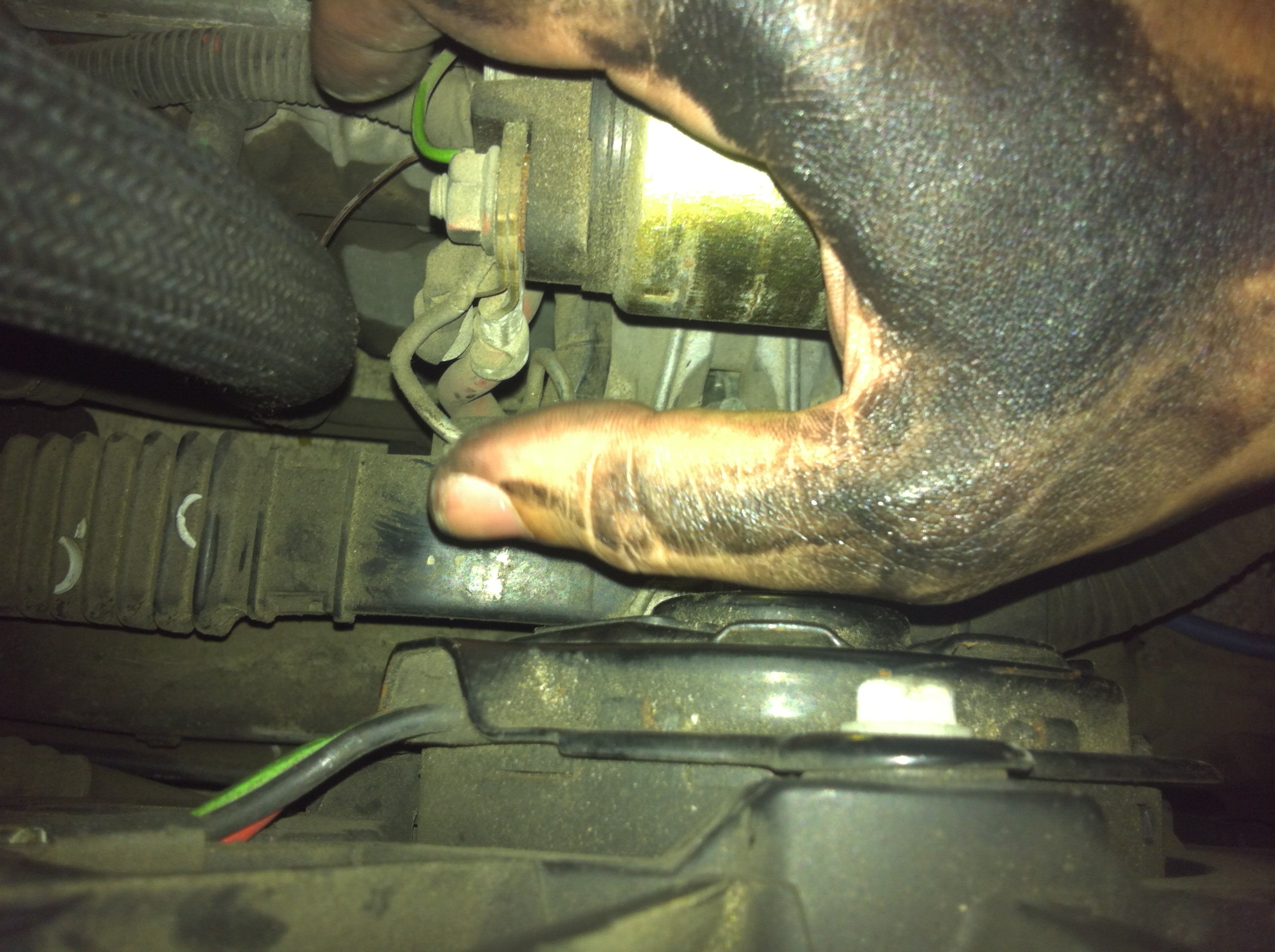

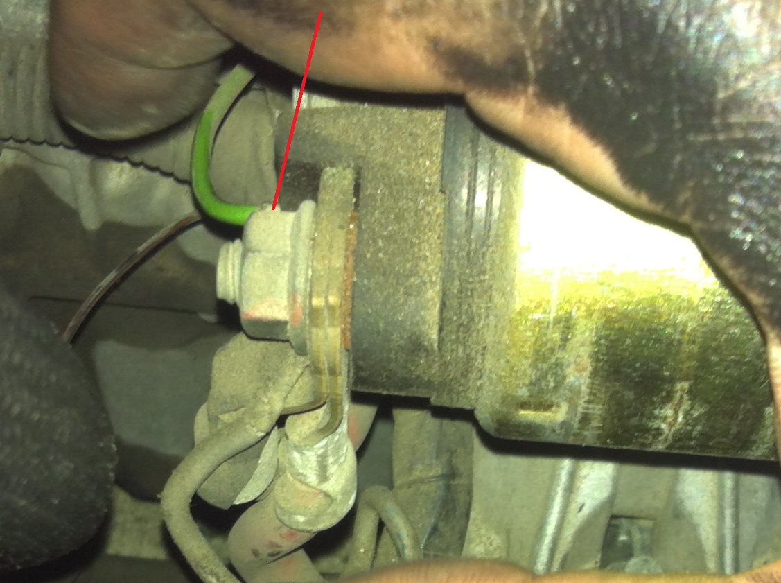

Leeming,
I had a similar problem, I first replaced the PNP switch, didn't fix the problem, then replaced the ignition switch and fixed the problem.
In order to understand if it is your ignition switch or starter, I would suggest you do this.
Bring the key to the 2nd position, the lights on dash will go on, get a long screw driver, locate the starter under manifold, remove the solenoid cover, it should come off when pulling towards the front of car. Then you will see a green wire and red cable that comes from the battery, now you need to make a contact with your screwdriver in between, you might see some sparkling, that is ok, if the car starts change your ignition switch. It is only 50 bucks and there is a video how to replace it on youtube, you will need a long torx screw driver to remove the cover under the steering wheel.
