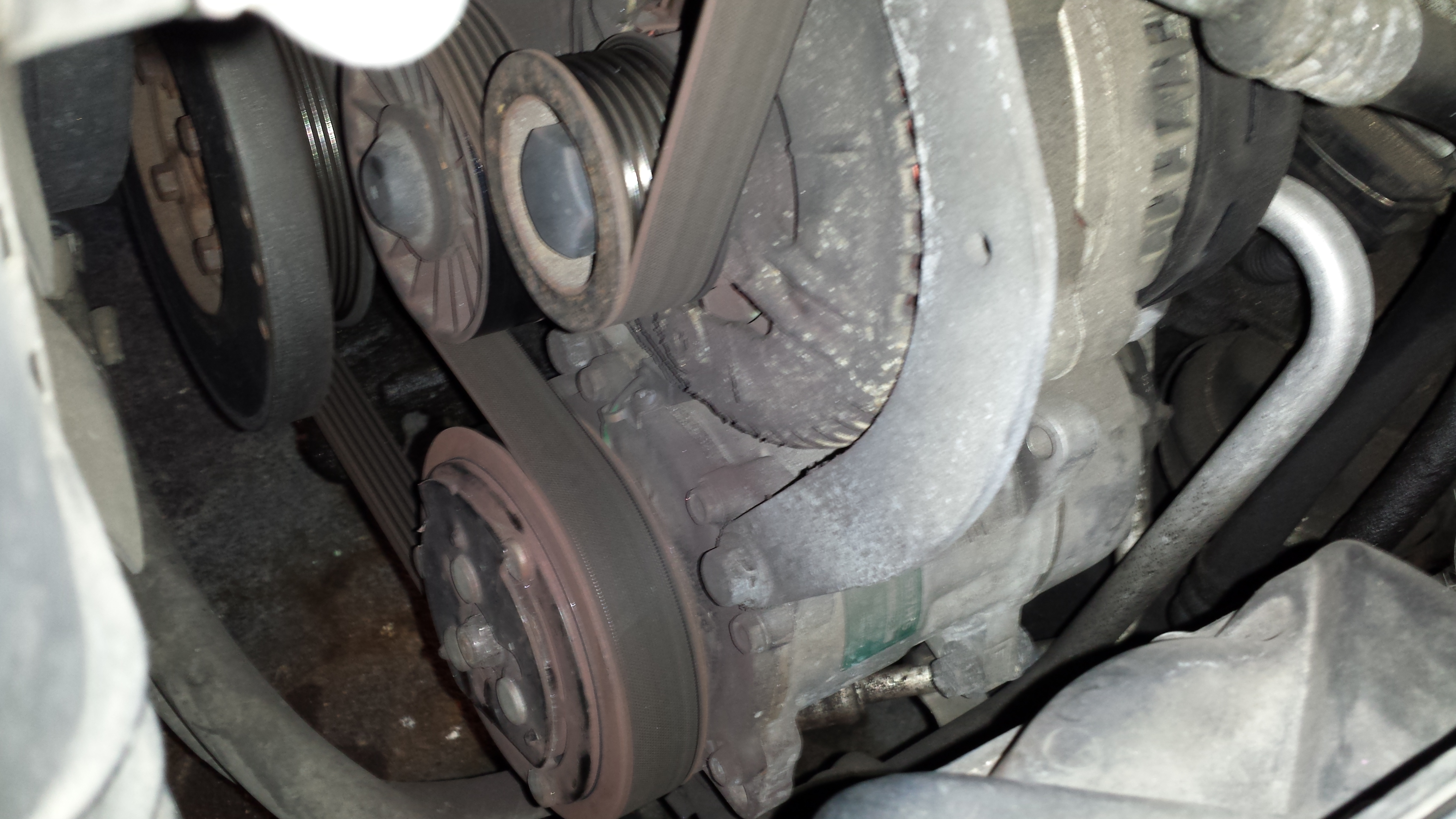

I have the following problem on my Volvo 960 wagon (1993):

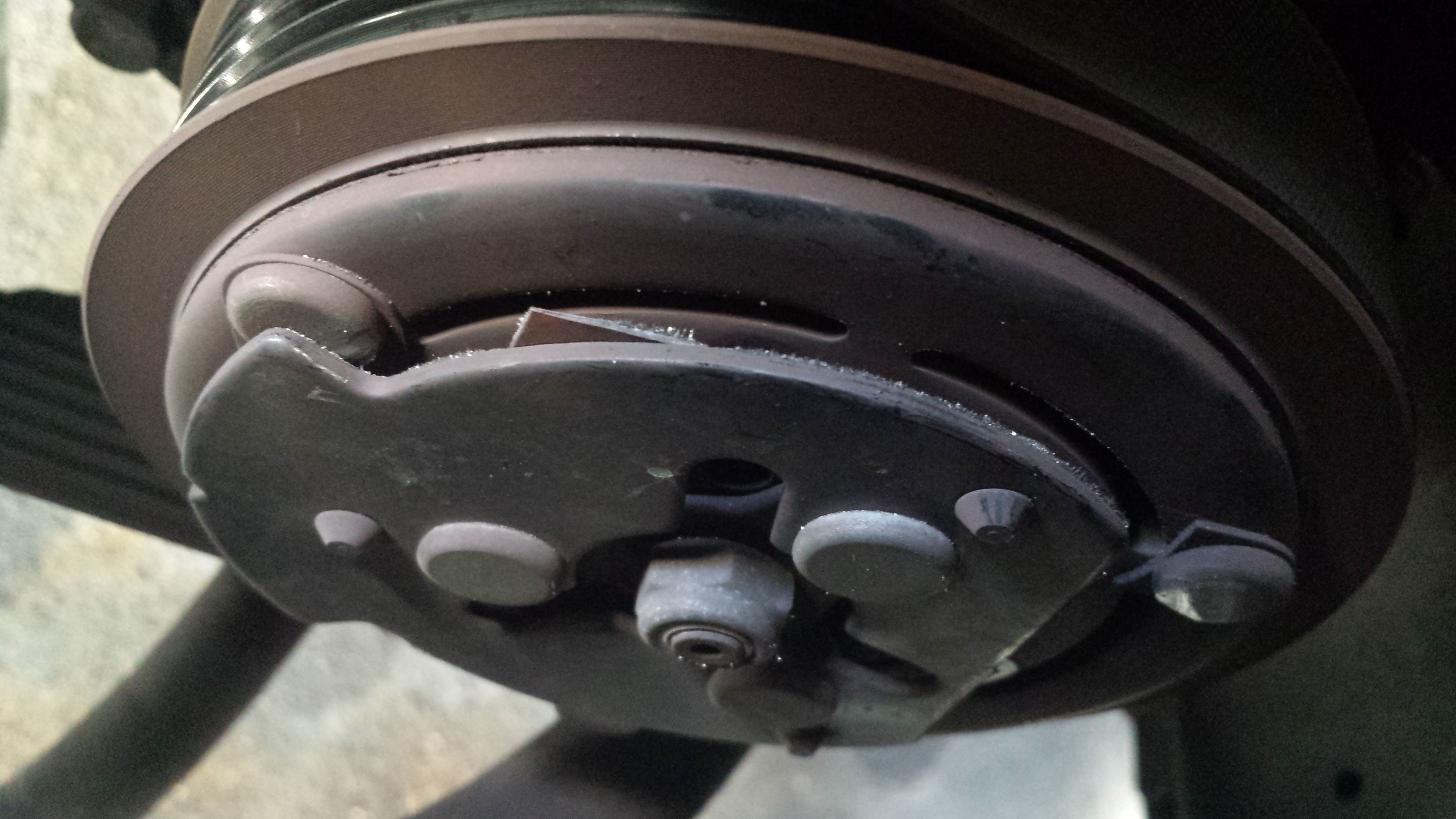

The AC compressor clutch front plate is broken (see pictures attached). This plate consists of 2 separate plates (correct me if I am wrong) which are permanently connected via a metal spring plate.
The spring plate is broken, causing the engagement/disengagement to fail. You can see the problem in this video:

Picture B: A photo of the clutch on my car
