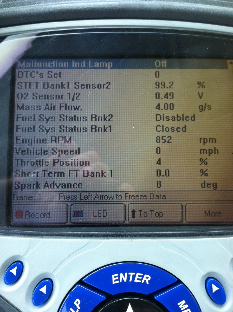

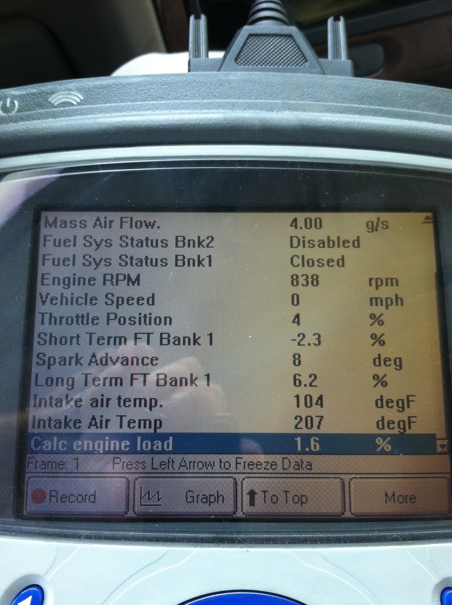

I grabbed a different scanner that gives me some additional info. I cleared the code again and drove it home (13 miles). Took a couple screen shots of it at idle before shutting it off. Only strange thing I noticed is 02 sensor went to 0.00% when I let off the gas and coasted (several curves on my road). Other than that I think things look normal. Not sure how to check both 02 sensors individually on this scanner as it only reads "1/2" as you can see.
Attached two pics as I had to scroll down to get last couple items.
Anything look out of whack? Would it help if I had cold readings for 02 sensor right at start up?
