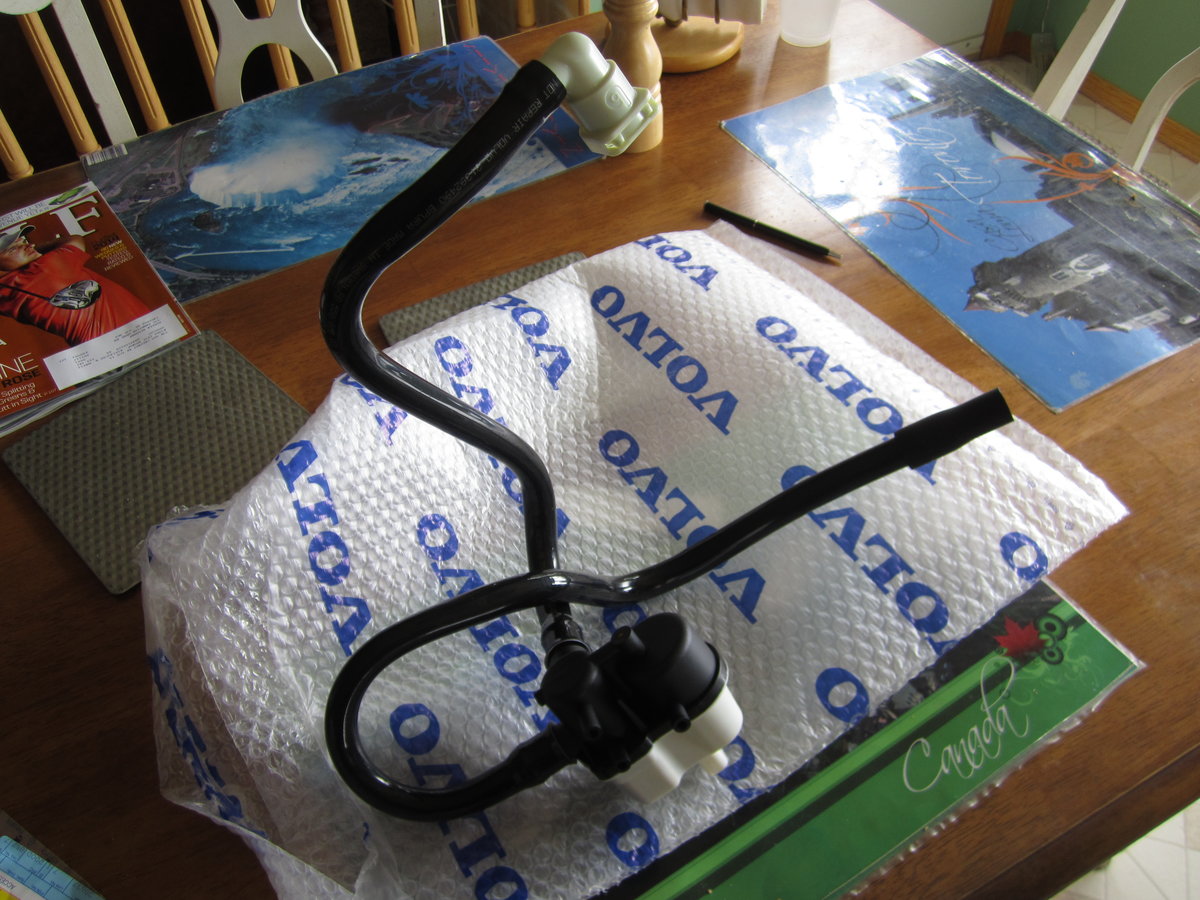

In my last post I asked if anyone could confirm that the part I purchased from Volvo was the correct part as it looked different to the Vida info. It turns out Volvo (in their infinite wisdom) have updated the part number to a generic part that actually fits only the XC60 as supplied (not 100% on that). Apparently you have to cut the 2 pipes off that are supplied with it and use your original pipes to make it work!!
Below is the pump as supplied.

I don't think so.
I just installed one (bought a new one), no attached tubing.

Possibly you have old stock, as the part number was updated about 6 months ago so I'm told. The part # purchased and I fitted was : 31392490 which is the one listed for my car.

Oh, forgot to say that when the 2 plastic pipes are cut off, the part fits just the same as the original with the same mounting points.
