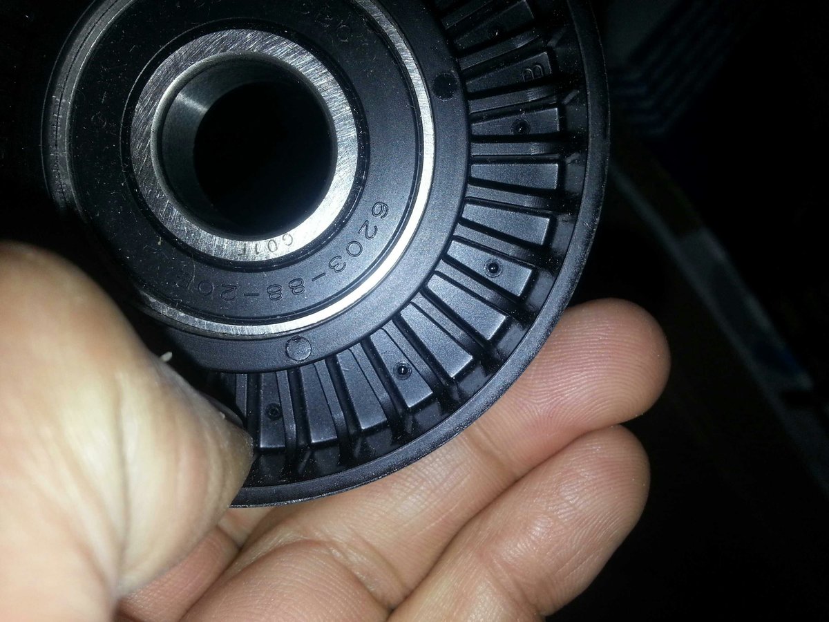

[attachment=-1]uploadfromtaptalk1401400636626.jpg[/attachment]Gates make the accessory pulley with bearing integral; around $14
The bearing is a 6203 however that will be a difficult one to press out without cracking the pulley.
