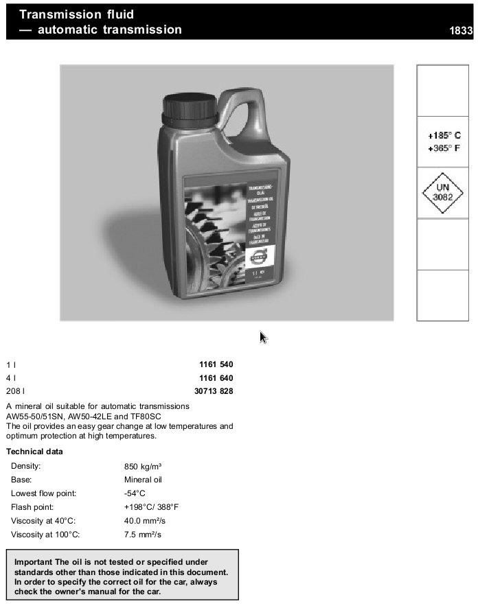

Sure.
http://www.mobil.com/USA-English/Lubes/ ... _3309.aspx
Code: Select all
$ pdfinfo Volvo\ chemicals\ and\ lubricants.pdf
Title:          Kemikatalog_08_front.indd
Author:         dwiberg1
Creator:        PScript5.dll Version 5.2
Producer:       Acrobat Distiller 7.0 (Windows)
CreationDate:   Mon Jun 16 15:18:35 2008
ModDate:        Mon Jun 17 10:04:17 2013
Tagged:         yes
Pages:          217
Encrypted:      no
Page size:      595.22 x 842 pts (A4)
File size:      3486240 bytes
Optimized:      yes
PDF version:    1.6

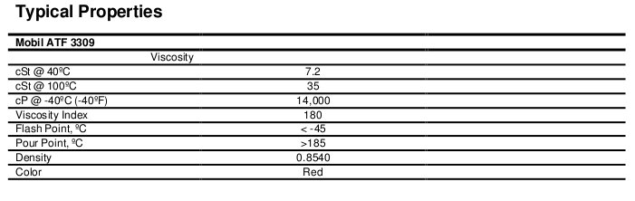

Other sites reference to different type of Mobil 3309:
I'm not sure which one is a mistake, but in both cases even density is different from what Volvo states.

Post by JRL »
Volvo is and they do this a lot, from misinformation, to incorrect owner's manuals.
Mobil has already confirmed (YEARS AGO) they make Volvo labeled 3309 fluid, the Toyota labeled Type IV and so forth.
Posts: 35278
Has thanked: 1500 times
Been thanked: 3812 times
I sincerely doubt the reported viscosity or density reported to 4-5 significant figures is reliable enough to draw any conclusion other than this document has been corrupted by Marketing.
