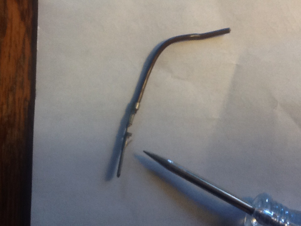

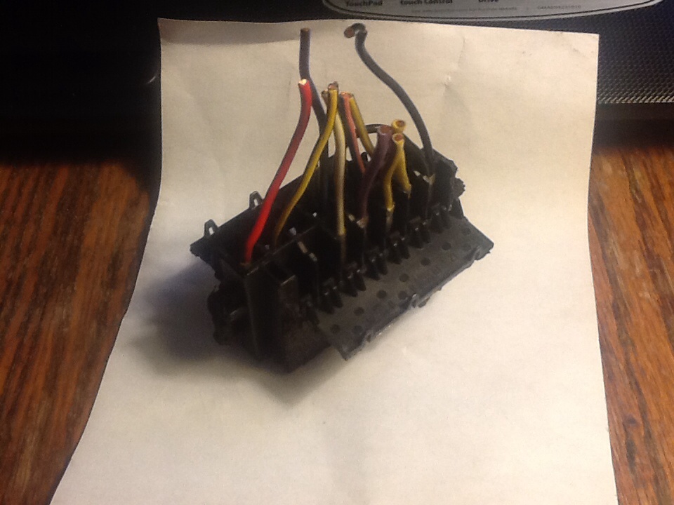

figured it out. there is one prong on these connectors that must be compressed. the pin then comes out the harness side of the connector.

That is basically what the extraction tool does. The only real difference is that with the tool you don't need to know what side of the hole the retainer tab is on. You just shove it in the hole and remove the pin but your method with a small screwdriver is just as good. Be careful when removing the pins you plan to reuse, the retainer tabs can easily break.
