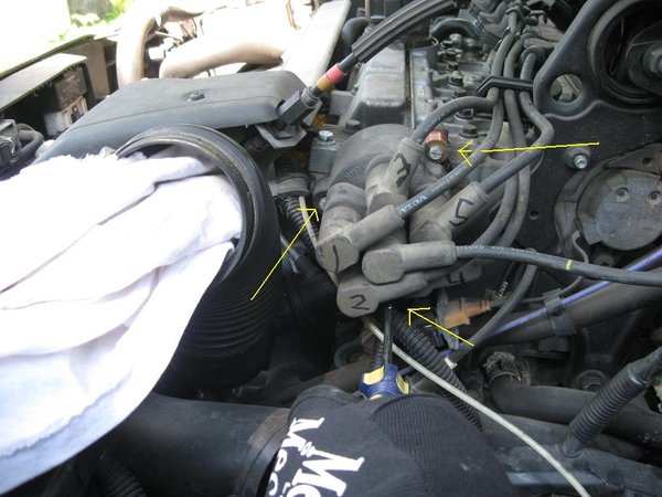

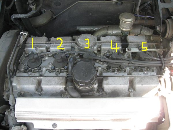

Are the plug wires attached in the correct order?
from https://www.matthewsvolvosite.com/forums ... =1&t=31425
