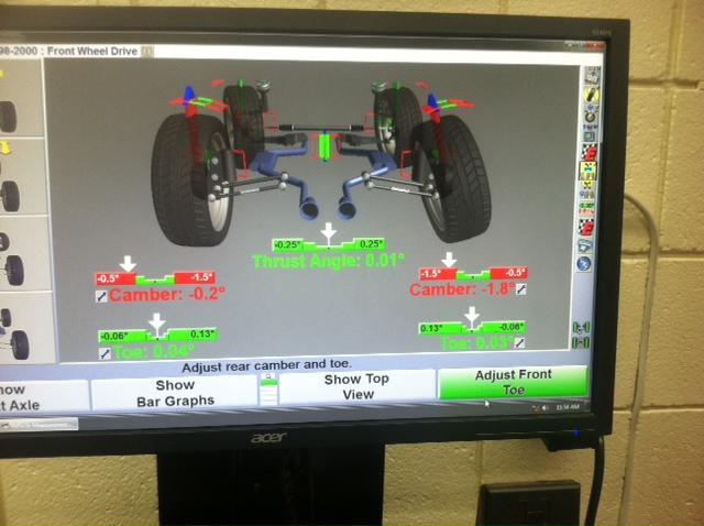

Replaced delta links and did not impact rear camber at all.
Replaced Trailing arm bushing on both side today. Passangers side very simple, drivers take a bit more time. Camber much worse on passanger side now. Drivers side off now, was not prior to parts change.
What am I missing? Attached is my after alignment figures. I am stumped. Any advice. May start a separate thread to discuss.

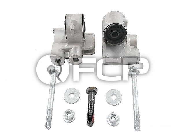

My boy @ Volvo says, that Volvo service center just updated their alignment machines and to get it done by them. He suggested changing the 4 bushings in the rear 2 on each side. Hope this helps MVS

Baptiste
I have replace all 4 of those bushings. Delta links (top picture) first, virtually no change to the alignment. Then the other two and seems to be worse now on the passangers side especially.
Is there an update to the hunter alignment machines? Or did Volvo update alignment procedures?
