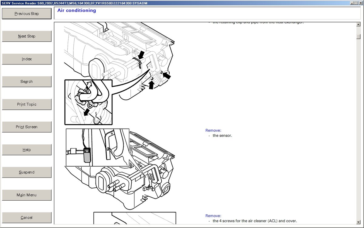

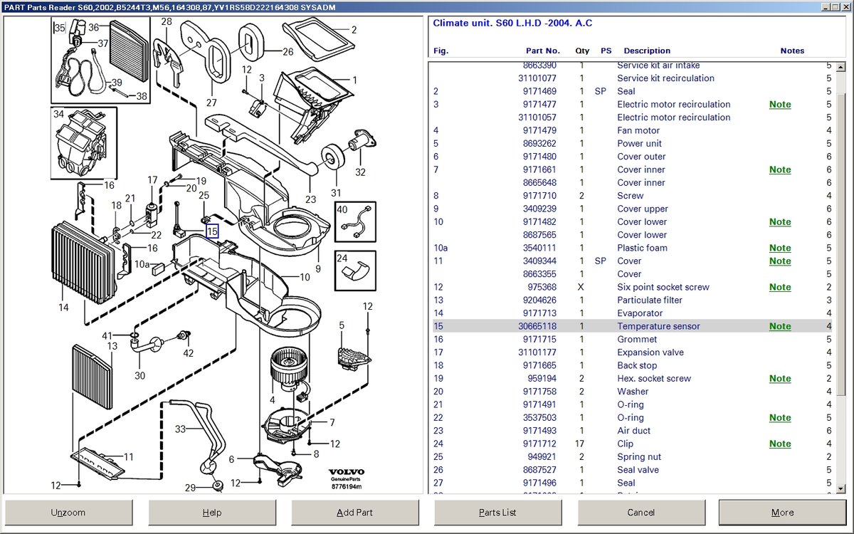

Vida shows me 3 sensors;
one on the receiver dryer (pressure sensor?)
one on / attached/ close to the refrigerant pipes inside the cabin (temp sensor?)
and one somewhere else (could be the same as the second one)
I try to put my hand on the first one (on the dryer) but the refrigerant hose seems to get lost underneath the cooling fan and the radiator. I can't see it. Do I have to remove the fan / coolant hoses to find out it is not there??
Mine is a 2002
