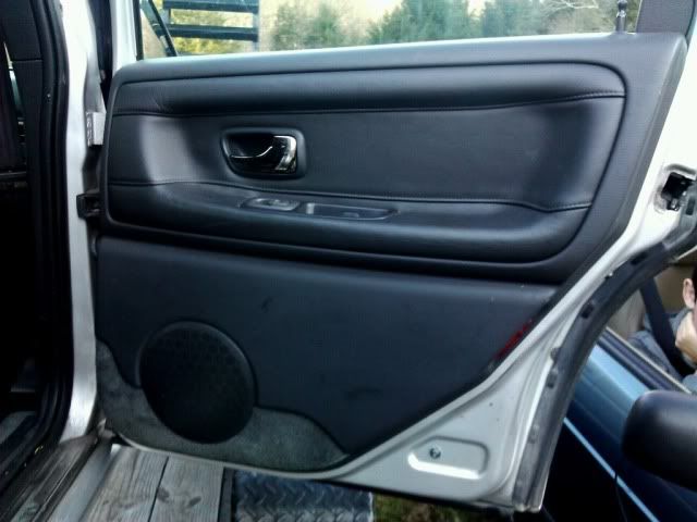

V70R's had this nice stitching down the leather on the sides.

The R designation is (was) an options package. R is the top of the line package (basically the order is base model, GLT, T5, then R). In 98-00 the V70 was available with an R package, the S70 and C70 were not. V70 and S70 doors (and therefore panels) are exactly the same. The V70R door panels are stitched, not just glued. They don't delaminate, they look better, and R owners may have a tendency to not trash their cars so quickly. May have.
