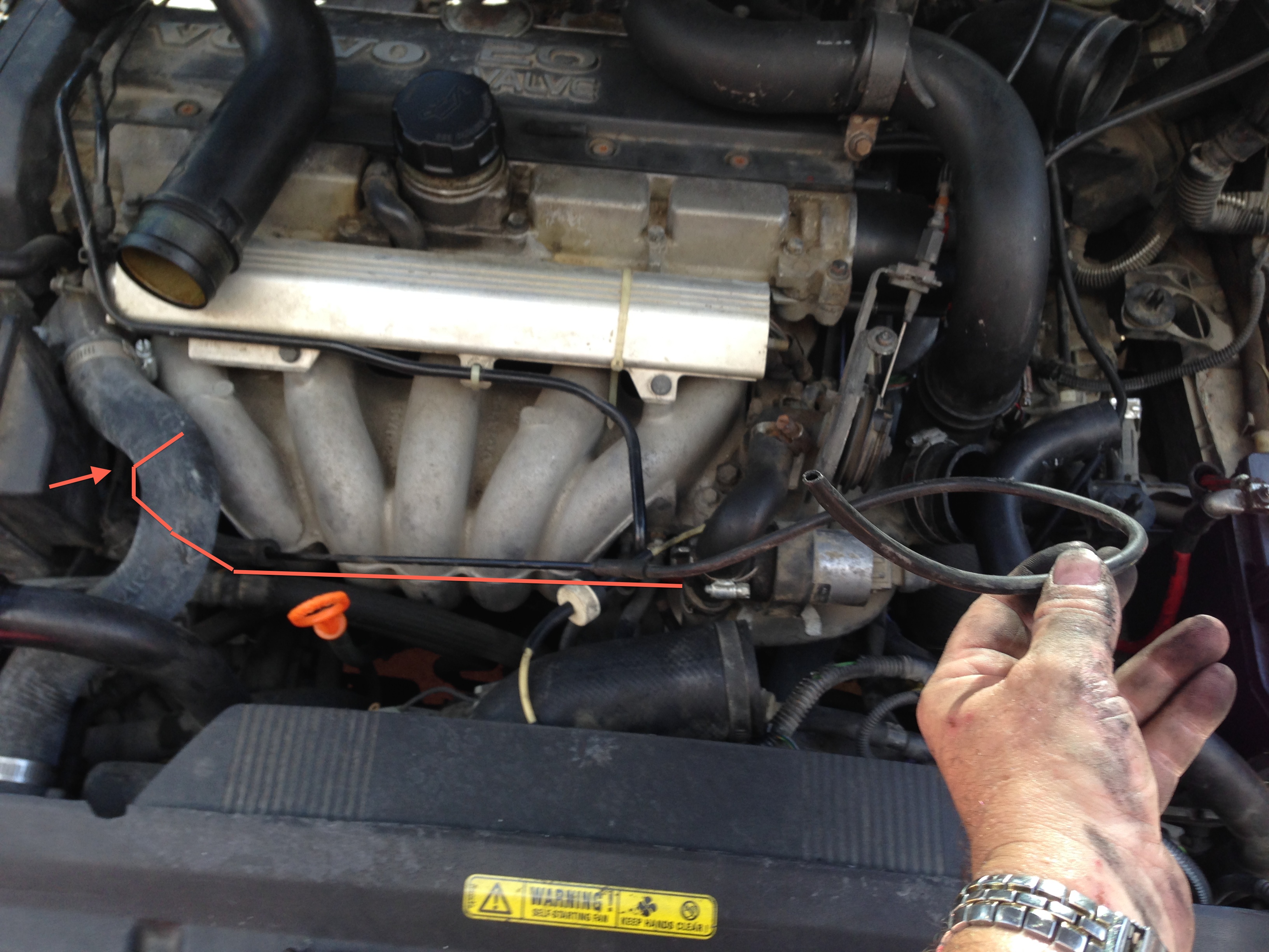

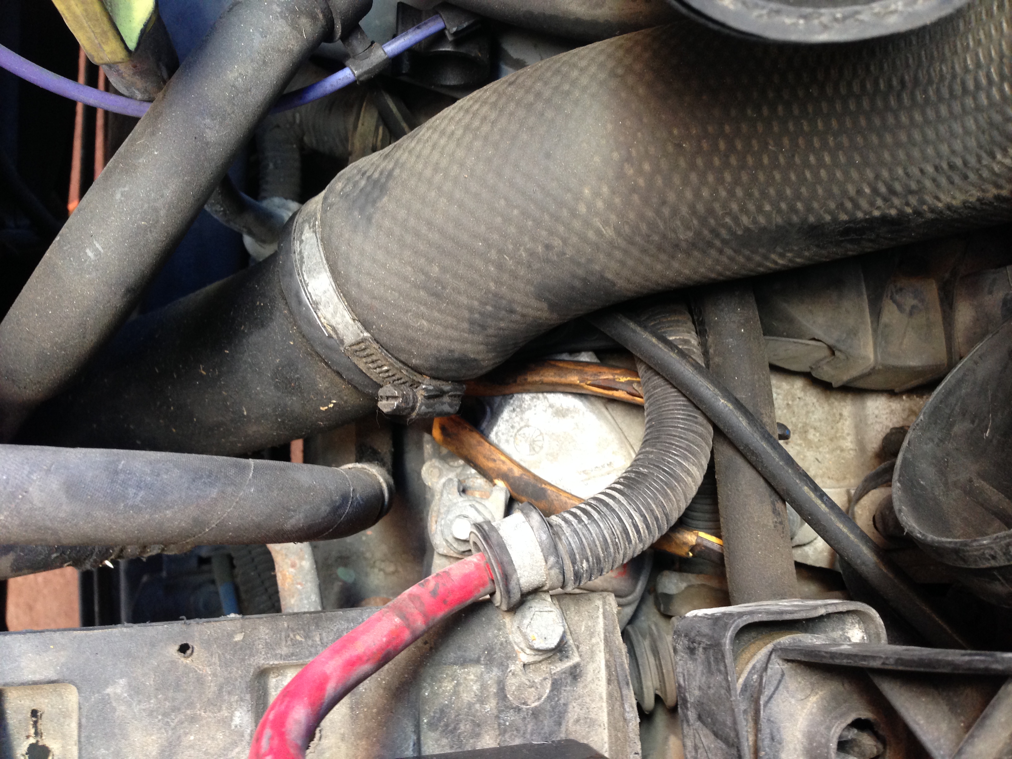

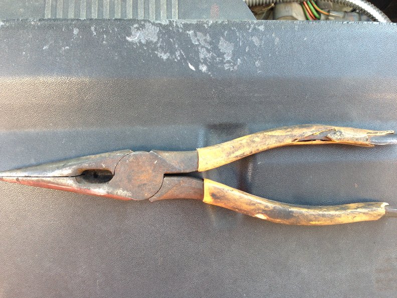

I found a vac line to nowhere off the left side of the intake. According to the diagram if I read it right, it should goto the flame arrestor PCV under the air box. but I don't see it. see pics. I also found a few presents under there.(Maybe the arestor PCV was removed?)
Present left by someone
Vac line from Left side under intake to nowhere
Looks like it supposed to go over here?

It's so nice that that 'present' did not land on the starter solenoid terminals... lucky you! :shock:
I will need to look up your vacuum and PCV lines routing when I get in my VIDA, yours is different from mine; hopefully someone may be able to chime in sooner.

Yeah I don't have a good diagram either. The TCV I don't think is right either, I need to verify the routing of all these.
I did replace the Purge valve & the rotted lines to that. I think all my other issues are these vac lines routing.
