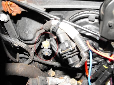

If you find yourself turning the dial and nothing happening, open the clips to the headlight housing and push the reflector back onto the ball socket it pivots on. I don't know why, but they seem to pop off a lot (might be why the level is way off).

Yeah, just pry in the middle with a small screwdriver and the clips will pop off.
The gears - you can put (I think) an allen wrench in the small gear. There's an adjustment behind the headlamp for height, a little white knob that you can again put a wrench into.

You will have to take the headlight out to get at the clips securing the front lens on as there are three on the underside of the headlight which you cant get out when it is in the car. Make sure you don't touch the reflective surface or the silver will come off.
The adjuster highlighted in the last post can be removed with the headlight in situe, they simply rotate through about thirty degrees, within the headlight this adjuster is connected to the back of the reflector by a ball and socket, it is usually this that pops out leaving the reflector - Mike

I was able to just remove the clips up top and push the reflector back on to its pivot.

"There's an adjustment behind the headlamp for height, a little white knob that you can again put a wrench into."
So the white knob will help me get the bubble in the glass window to the black line?
I will assume that those gears on the top adjust from right to left.
