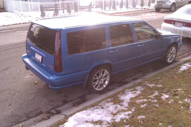

The elephant here is the hub size. The 2008 - XC70 is smaller than the 850. I think if I remember the hub size is 63.Xmm for this car, and 850/P80 V and S70s, P2 XC70 are 65.1mm. I bought a set of 2008 rims from an XC70 that were listed as from a 2007 and they wouldn't fir my 06 XC70.
Width wise you also have to watch out for. Standard is 43mm offset on the rims. A bigger offset number may cause the tire to foul on the brake line or strut assembly. I am running 2005 S60 17" rims on my 2000 V70R with 225/45/17 tires. These clear but not by much. Need to check both front and rear for clearance.

@ scot850: Don't sell it, it's too nice!

+1erikv11 wrote:@ scot850: Don't sell it, it's too nice!
Beautiful R. Those wheels looks awesome on that car.
