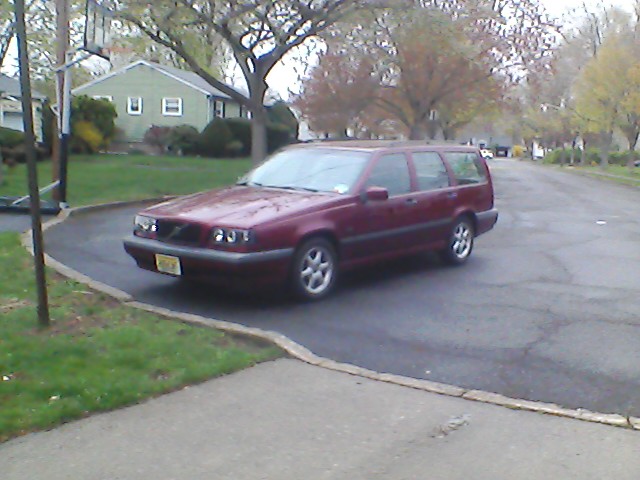

From your picture it looks like you have some great looking projector style front lamps which were not factory. Do you know if the factory wiring harness was used with the replacement lamps? If the new headlight assemblies required splices when they were installed that is where I would start looking first.

Yes, the car now has projector headlights in it (one of the originals was cracked, so I upgraded), and they have worked perfectly since I installed them about a year ago, they plugged right into all the factory plugs. Both headlight assemblies work perfectly when plugged into the driver side of the car, and both have the same problem when plugged into the passenger side of the car. The problem is definitely in the car itself somewhere. As I said, I checked the plug itself for blinker and running light power, and the blinker pin flashes just as it should even using the test light, but the marker light pin is dead. I will try and test the marker power wire itself father back from the plug pin and see if there is power there meaning I need a new plug. Thanks
