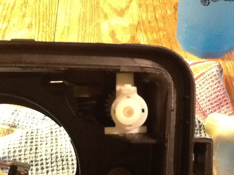

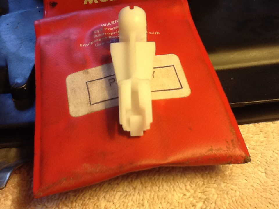

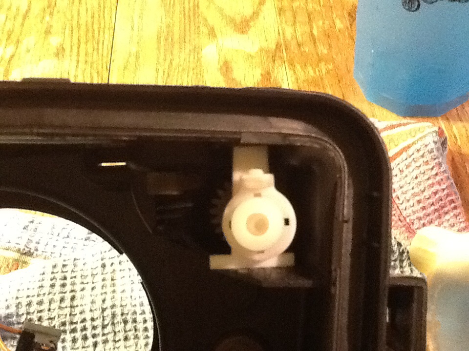

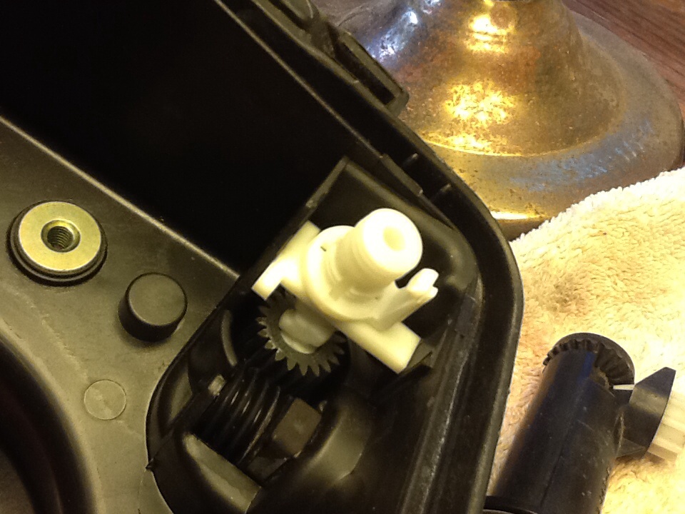

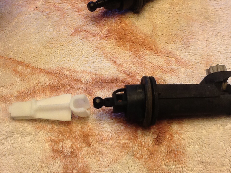

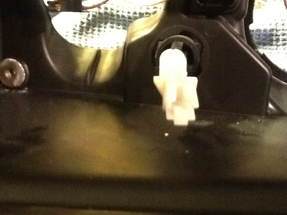

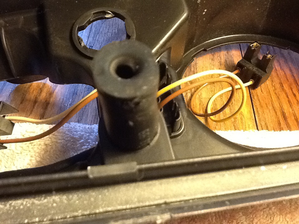

Here are some more pictures. The tricky part is disconnecting the ball mount. I reached thru the back of the housing with a screwdriver and separated the ball from socket.
Ball goes into socket
Cornor is slid into grooves
Peg goes into this flex hose nount

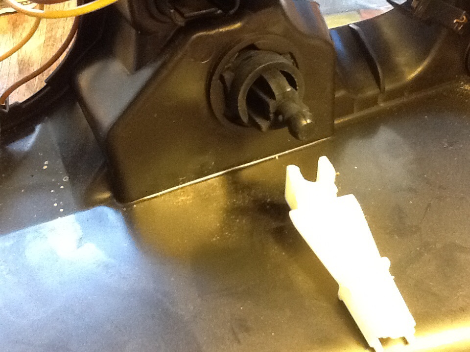

Black adjuster comes out
This is clipped into silver lens, poor access
