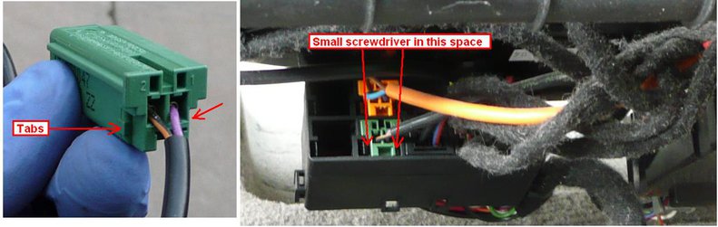

No special procedures other than to not have the connector unplugged under front of seat with key on. You can get everything but the connector swap done and then turn off ignition, wait 5 min and then disconnect battery before you unplug the seat gang connector.
Your biggest challenge with the buckle is wire routing and getting the buckle connector out of the gang connector under front edge of seat.

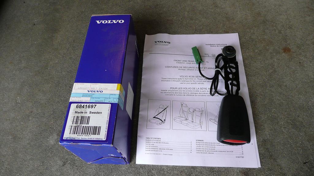

* PN for Seat Belt is 6841697, $65 at dealer, or amazon (some dealers sell through amazon, ebay etc.). It is reversible to fit both the driver and pass sides.

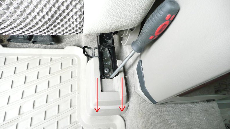

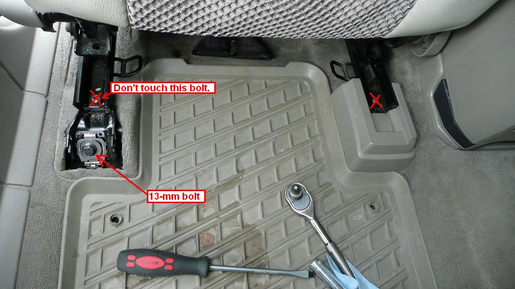

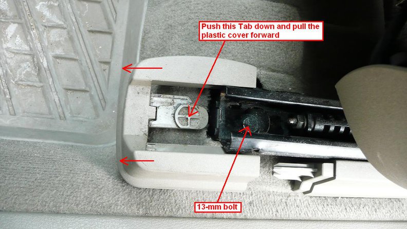

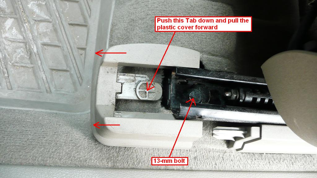

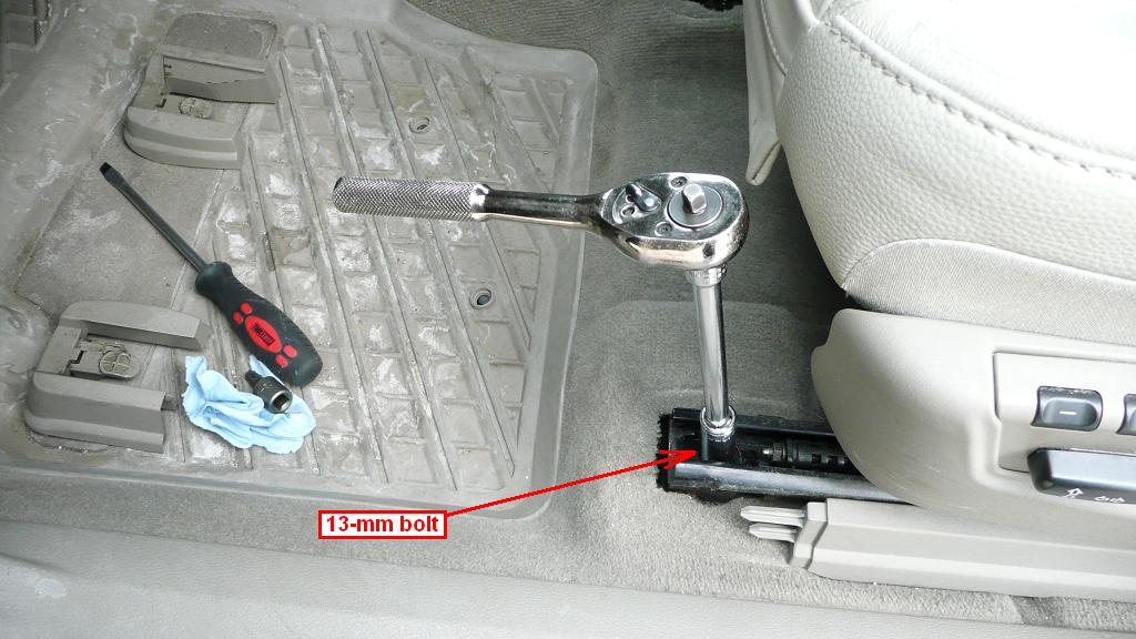

2. Move the whole seat backward to expose the front bolts. Remove the plastic cover as shown (press the tab down first) to expose the 13-mm bolts.

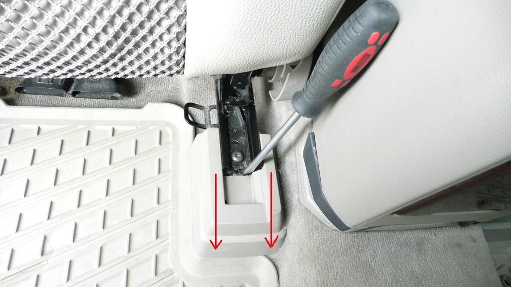

3. Now move the whole seat forward to expose the rear bolts. Use screwdriver to pry as shown.
4. Now, move the whole seat back (where you lean your back against) all the way forward. If you don’t do this step, when you prop the seat up (to expose the green connector), the headrest will touch the ceiling.

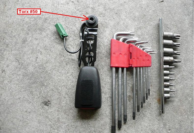

6. Move the whole seat it rearward to expose the buckle mounting bolts (T50). Undo the bolt.

9. Look at the new part, you will see 2 tiny tabs. Now you will know where to insert the small flat screwdriver to d/c the green connector.

Any photo of the NEW part so we can help?
Just look at the new part, it will give you some clues on how to undo the old part.

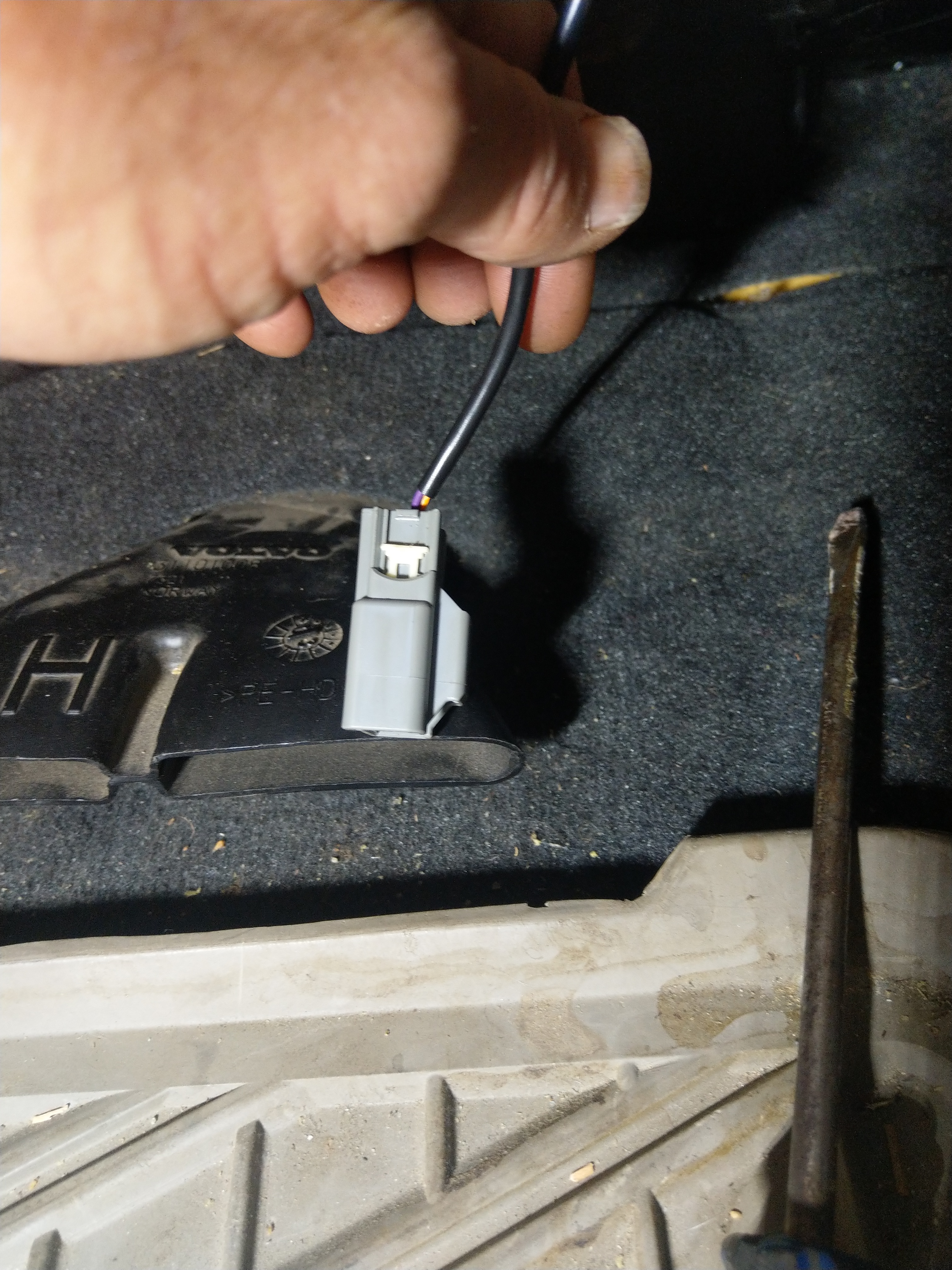

I gave up and took the car to a Volvo garage. They informed me that the entire connector box needed to be removed and disassembled. So, essentially the connection unplugs from the front! They didn't say it had to be done this way since I messed up the tabs while trying to unplug from the rear.

For the connector, there is only one release tab to push back on the bottom left of the old connector (which you need to push to the left), and which you can see in the final picture above. The OP implies that there are two tabs, but there is only one. If you need a reference, look at the empty connector slot to the left of the one where you insert the green connector in the picture – there is a little black tab in the bottom left that you push to the left to release the connector. The PITA is that there is so little space down there and you need to get two hands in – one with the tiny flat head to push the tab and the other pulling on the wire to get the old connector out. I had to use some coordination and force to eventually get it out.
