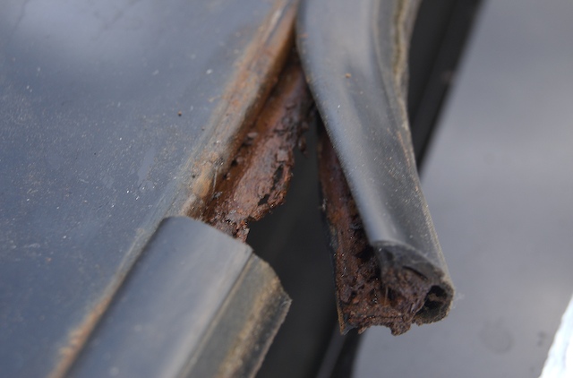

I too was mucking with my moonroof lately. I tried to fix the two ends of the trim buckling, but when I got into it I saw the rust behind the trim strip goes all the way around the glass! Ugh.
I ended up removing about half the trim, drying the rust, removing what rust I could, then gluing back the trim with a sealant called "Liquid Nails." The result was less than spectacular, primarily because the sealant is very thick.
Here's some pics:
