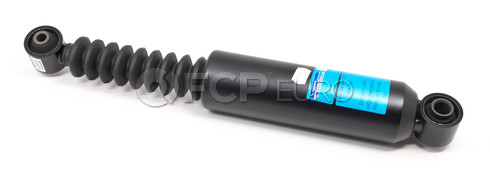

One is 1997-1998 Volvo V90 Rear Nivomat Shock Absorber-Marked "V".
One is 1997-1998 Volvo V90 Rear Nivomat Shock Absorber-Not marked with "V"

schoolhousejulie wrote:I need new rear shocks for inspection.
$232.99
1997 Volvo V90 Base 2.9L L6 Shock Absorber
Position: Rear

This is what I found listed:
with Nivomat (not marked "V"): OE 9173202
with Nivomat (marked "V"): OE 271897
w/o Nivomat: OE 272220; Sachs 124816

So I was given the part number 444092. I was confused because on FCP there is: "not marked v" (mine is marked "H") https://www.fcpeuro.com/products/volvo- ... t-marked-v, then there is the "marked v" (which has 444092 listed as cross reference) https://www.fcpeuro.com/products/volvo- ... 0-marked-v, then on IPD they have only the "marked v" which matches the FCP listing (mine have the same sticker as the one you see on the shock in their listing with 60-A92-0 on them), then there is eEuro http://www.eeuroparts.com/Parts/73441/S ... r-9173202/
I initially ordered the "marked v" from FCP because it matched the part number that my mechanic gave me. However, two days later I found out that they were unable to get me the part. The service rep at eEuro told me that their 272209 they have listed is what replaced 271897 once it became obsolete.

Shock absorber kit; MARKED Y, H Volvo Part number 272220. Fits 95-97 960, 97-98 S90, and 97-98 V90.
http://www.volvopartswebstore.com/produ ... 27220.html
Marked Y or H: Volvo 272220 rear shocks are not nivomats. They are stardard shock absorbers.
http://www.fcpeuro.com/products?keywords=272220

Okay, I see the "H," but in product images, it shows a Nivomat shock. But, looking on IPD, FCP and eEuro, all part number 272220 is a non-Nivomat https://www.fcpeuro.com/products/volvo- ... -advantage
$232.99
Position: Rear
This is a nivomat.
