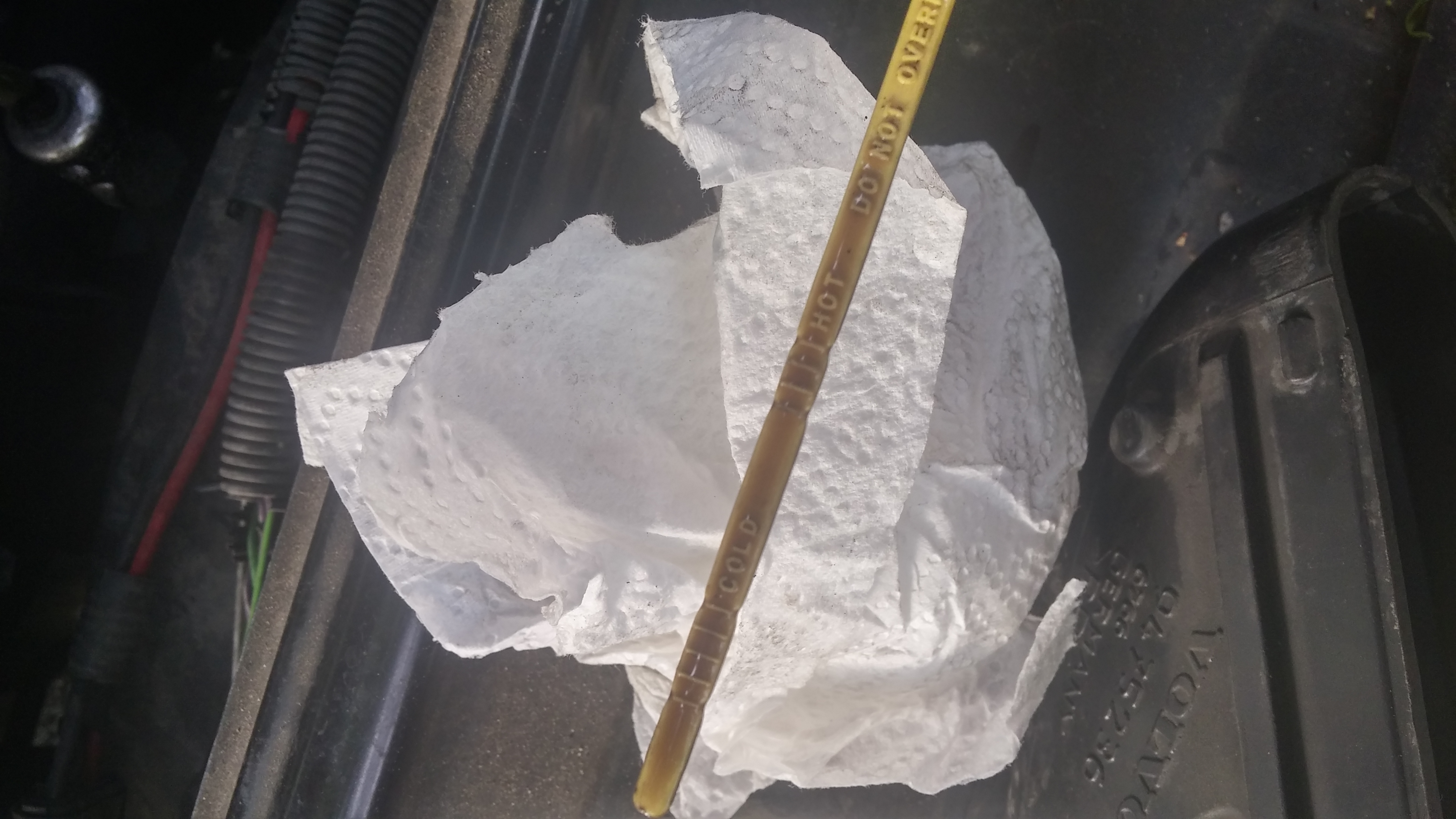

Okay, thanks for the feedback so far. I appreciate it. took a while but i did locate the ATF dipstick. Here is a picture of it with a cold engine not driven in a week. It looks like the fluid level is to high. It goes all the way past high to the 'do' of 'do not' It also looks pretty dark. I would need to talk to me mechanic but I think he flushed it a couple of years ago.
- Posts: 36137
- Been thanked: 4064 times
Look up the transmission oil checking procedure in the manual. I believe it's with engine idling, warm,and after shifting through all the gears. It's very different than your engine oil dipstick
