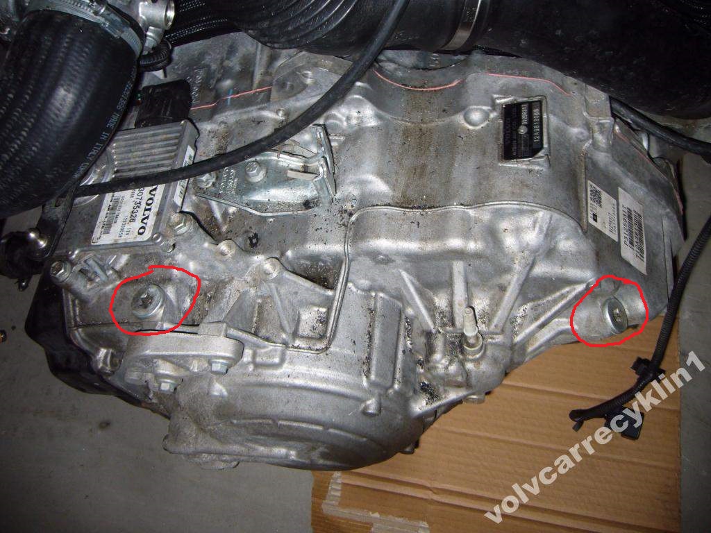

Can anyone tell me which is the right plug in this pic!

Hi guys. new d5 s60 volvo owner and want to flush my 6 speed tf80sc box. However i can see two hex bolts which could potentially be fill plugs. i dont want to get it wrong and goose my gearbox so wondered if anyone could tell me if its the plug ringed in red on the left or the right of the picture for filling? Thanks very much

The one on the left (front)- the one on the right(back) will release a band and you will have to rebuild the trans.
