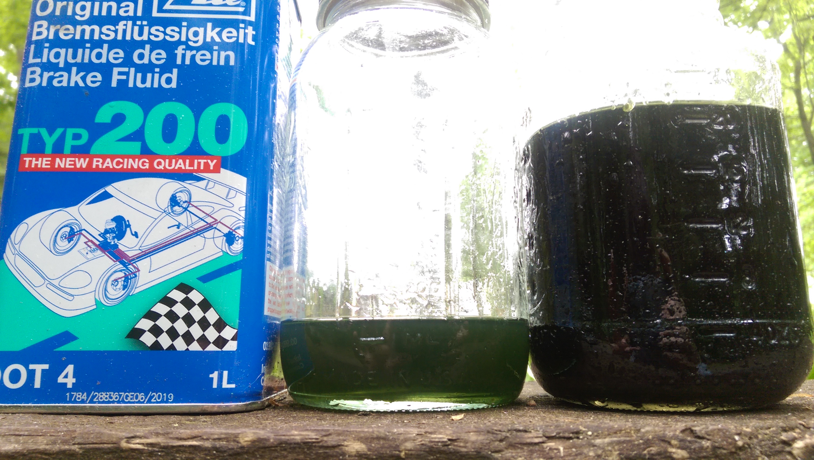

Nearing the end of the stage 0+ restoration of my wagon, I replaced the front brake flexible lines after fighting with the seized nuts on the hard lines. Recently I replaced the brake fluid and today while bleeding the line I get discolored fluid from the bleed. See photo.
On the left is the type 200 fluid I used. Middle is what I bleed today. The right is what I flushed out last week. Am I just over concerned about what came out today? I guess it's some mixing of leftover old and new fluid.

There is usually an order in which I was taught to flush a brake system. Starting with the caliper closest to the master cylinder and working from closest to furthest, making sure clean fluid emerges before moving onto the next. Sometimes air can get trapped in the system after bleeding, so my suggestion would be to re-bleed the system. Old fluid absorbs moisture and eventually gives a spongy feel to the peddle.
