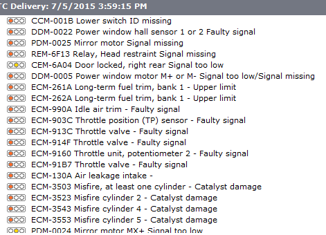

I got a ton of codes on two different runs - see the pics. After a few starts, it started running fine again. I cleared the codes, and have nothing now, so I'm going to see if I can get it to trip up again today.
I'm still thinking throttle body, but I haven't done anything yet since it's such a pain to get at. I guess an air leak could be involved, since a lot of the codes point to that, but it's intermittent, which doesn't sound like an air leak to me (could be wrong, but why after 20 miles of trouble free driving?). I sprayed some TB cleaner around and didn't pick up any indications, but I probably need a proper setup to check for leaks. Any suggestions for doing this on the cheap? I'll search a bit. youtube didn't help me much here yet. The Volvo tool sounds good, but probably expensive.
I took your advice and got DICE/VIDA setup, which was a huge pain to get everything working properly. I don't think I've used it to its potential on this problem yet, but wow - that thing is cool, well worth the price already. I've got a lot to learn on this, so I'm kind of stumbling through that now.

These codes appear to be taken at least 45 minutes apart. I assume that you are scrolling down to clear all codes before retesting in the delivery tab.
The predominant thing I see that will prevent smooth running and even prevent startup are the throttle codes.
However being a Bosch unit I'm hesitant to see you spend $300 on a new unit. Because the connector pins to the Bosch throttle have been blamed in the past it would be interesting to grab a throttle connector from any 2002 onwards turbo car from a junkyard and solder it to your loom. If you're really good with wires you could splice 2 throttle connectors in, leaving the original intact.
My first stop here would be to remove the ECM (engine control module) and clean the strip connector thoroughly with electrical contact cleaner and a toothbrush.
Way too many codes to be a group of suddenly failing engine components.
- Posts: 36147
You also have an air leak fault. This could be the source of about 1/2 of your codes being displayed...all the misfire codes, etc.
It's much more common to have failures of hoses, clamps, holes, etc. than components in these cars.
Let's see which codes come back first.
