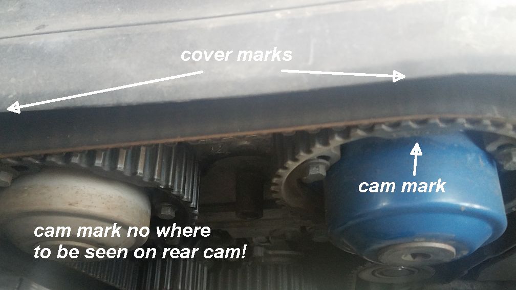

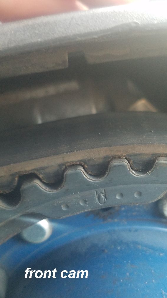

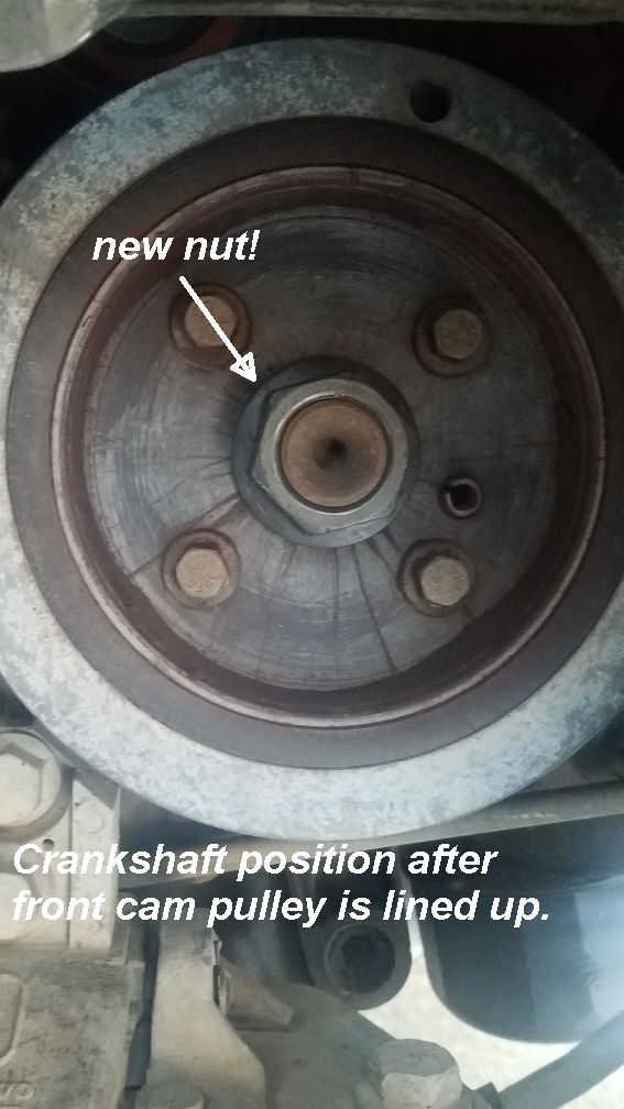

Update time. I finally got a crankshaft nut from Volvo and have dived back in. First things first: Check those timing marks! Well, the front cam lines up nicely and the back cam ain't near it at all! Is this a problem? I don't EVEN want to continue if we have blasted the valves because something really went wonky! This is what I found. I have not shifted the belt at all. The belt has nice tension. Nothing looks out of place (Except the cams!). The entire job was done AT VOLVO dealership 30K ago.
- crank.jpg (95.19 KiB) Viewed 1538 times
- both cams.jpg (78.08 KiB) Viewed 1538 times
- rear cam.jpg (81.35 KiB) Viewed 1538 times
- front cam.jpg (70.76 KiB) Viewed 1538 times
- mrbrian200
- Posts: 1554
- Joined: 20 Jan 2016, 08:47
- Has thanked: 7 times
- Been thanked: 84 times
Please explain exactly what you performed.
Did you inspect or replace this guy? Regardless whether or not the gear on the crank needs to be replaced, if you didn't remove or loosen the timing belt the intake and exhaust pulleys should still line up with their respective marks independently of where the crank is. This points to a failure in the belt chain (tensioner, pulley, water pump, or stretched belt).
