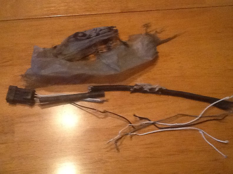

As wife was driving to store yesterday, noticed something hanging down from car. Forgot about it till this morning. It's wires. So I assume something has come loose and causing the problem, or my local groundhog mechanic has been working on the wrong car. Will check it out after work today.
Thanks for the diagram. It will come in handy.

Here's what I found tonight. The Walmart bag was melted to the cat and you can see what a mess the wires are.
Are there any major problems driving the car about 70 miles tomorrow. Misses has appointment and wants an answer from someone other than me.
Will it shut off or just run a little different?

Would it be a good idea to rewire?
And are the white wires the same?
Yes depending of your skill to solder new wires with heat shrinks. Most will simply replace the sensor at this point.
They are the heating element. No particular polarity on them.
However with the other two wires you must respect polarity.
I suggest not to run for long without the sensor connected. At least not with the hole unplugged (exhaust leak). The rear sensor is there to monitor CC efficiency.
Hopes this help,

Thanks for the reply. Working on the rewire today. Hope it warms up a little. Not quite 100 yet.
Anyone know the nut size, before I crawl under there?

One more question. Will the CEL reset it's self or do I need to do the battery removal?
Could not budge the O2 sensor, so I work with everything under the car. Not my best work, but we will see what happens.
