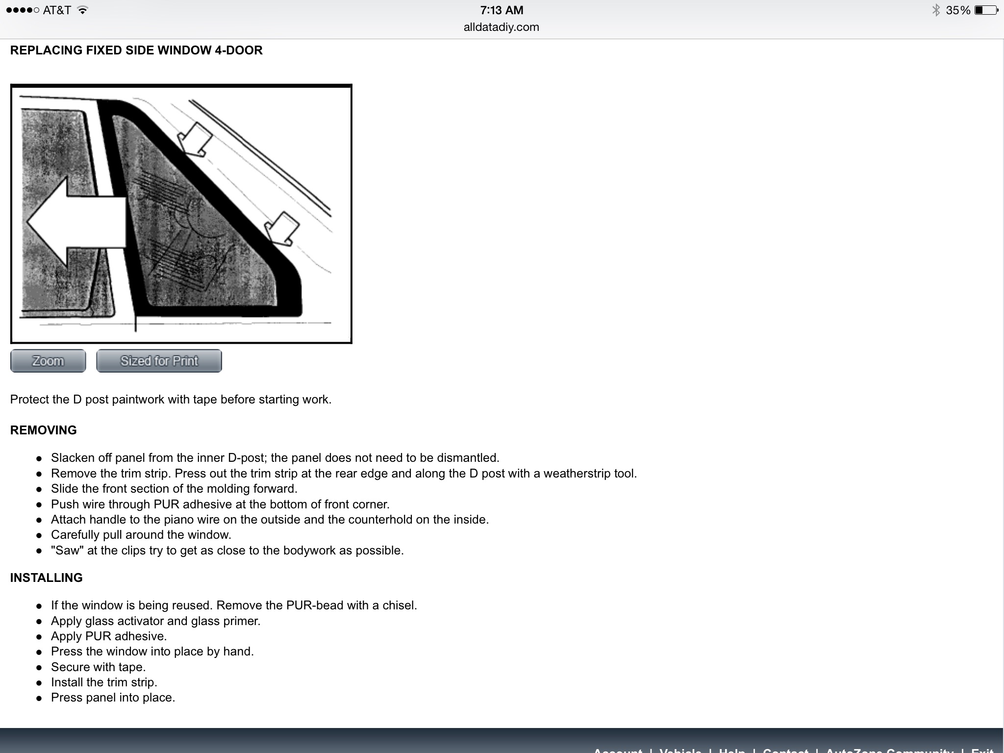

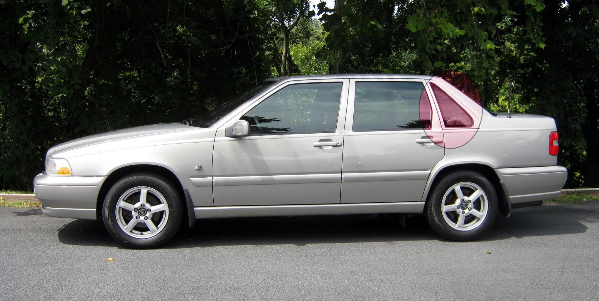

So, I locked my car and the battery went dead. Keys nowhere to find. In desperation to get to my work papers I decided to smash the least expensive window. That is what I thought at the moment but now I'm starting to regret this a lot.
How do you get this window out? Please I will love answers since im on on a very tight budget...
1999 S70 T5 - replacing quarter panel glass
