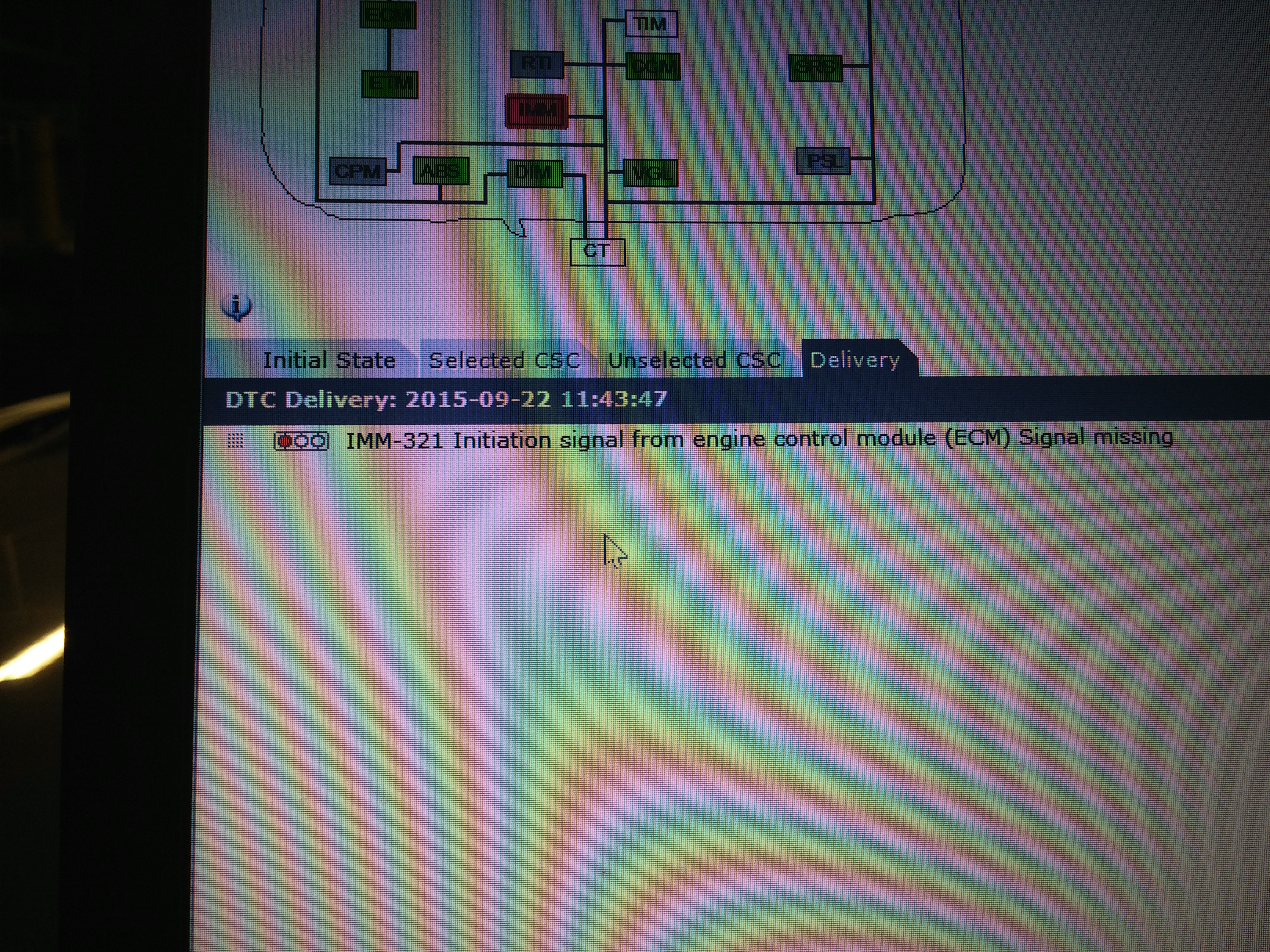

1 km from my house the battery icon appeared, then the CEL, then the car sputered and died. I had it towed home and now I'm struggling as to what on earth this problem is (The nearest garage is a volvo dealership and I'm a student and I've just lost my job (yeah! /s), so that was a no go). While I was waiting for my towing, I checked the cel with a cheap obd2 scanner, and code p0350 appeared, along with another similar one (p0350d? p03501? p0351? I dont remember :( ). At the time, the engine would crank but not start. Ive tried erasing the fault and nothing changed, the car cranked but didnt want to start. Now its in my garage and Vida tells me I have imm 321 fault code stored, no other dtcs, even with the cheap scanner, and whilst trying to find the problem, the battery completely discharged (its not a new battery, but not old, never had a problem). The car was OFF, key in ING II position, dice connected to it, headlights open and nothing else, and within 15 mins the voltage at the battery dropped to 6v, causing the car to stop communicating with dice :( . The car doesn't want to crank, it just emits a semi-loud pop when I try to start it, but I have no idea if thats just caused by the dead battery, since its been off for an hour since the first problem before I could try to start it again, and the pop is the same as if I had forgotten my lights all night long.

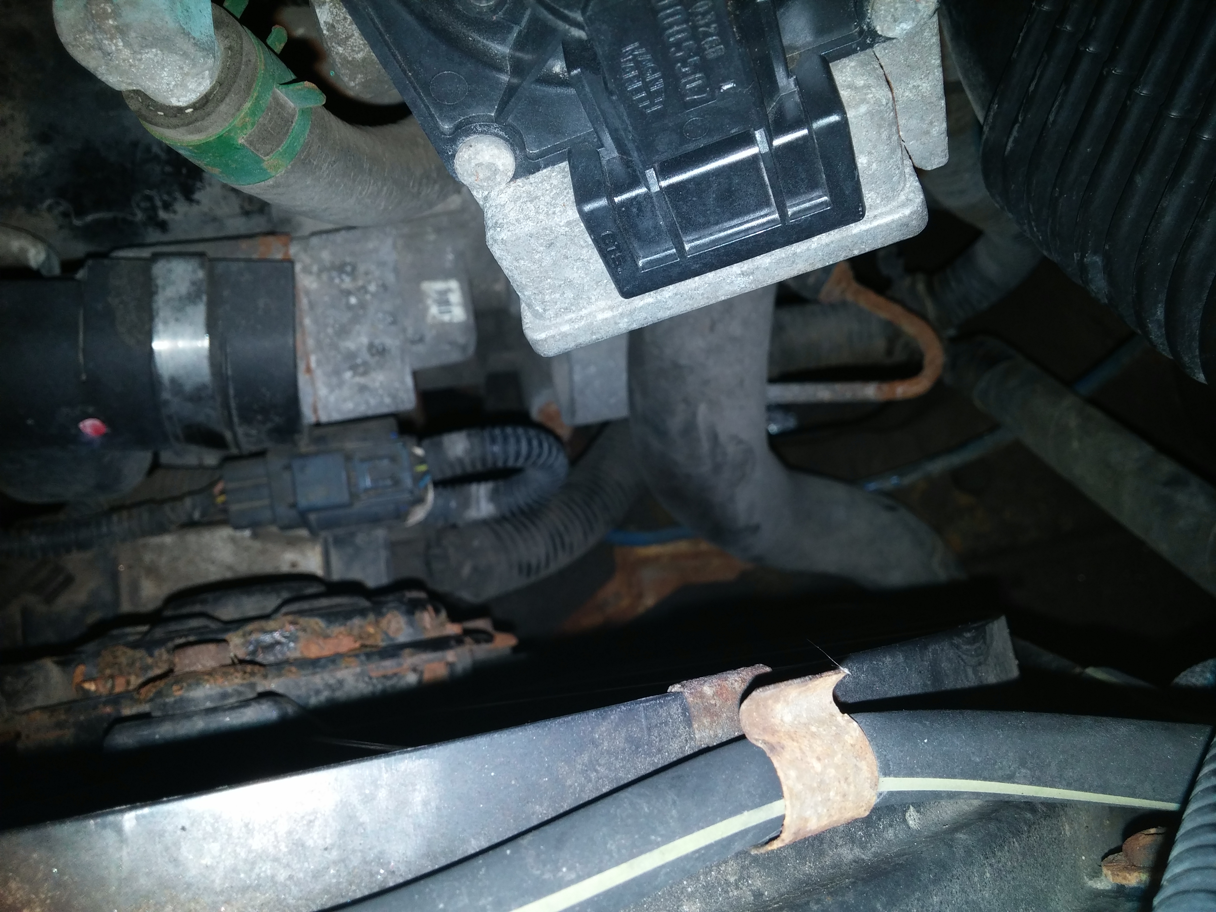

I have frayed some ignition coil cables when I put back the engine cover, like so
Note that since I've cleared the srs fault and checked the sparks (and frayed these wires) the car has drove for about 500km, one week.

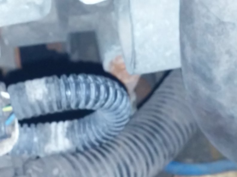

Also, while checking the sparks, ive cleaned a grease patch with water and degreaser, and some water fell onto a wire (at the intersection of the blue, which seems to be connected to my pos battery terminal, and the black bunch of cables
It smoked a little when it happened, the smoke seemed to come from between the blue wire and black cable, I've disconnected my battery, dried the connection, reconnected the battery and everything was good, no visible damage and no more smoke. I havent driven in water or rain in the last week and the wires are dry.

Third, as far as I remember, your trouble code suggests that you've got a short somewhere (also your battery issue), and that your immobilizer can't talk to the ECU.
I suggest you start with the smoking wires. If there's smoke, there's damage, and that's probably where your culprit is.

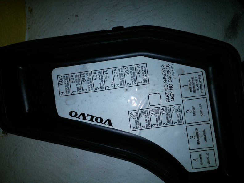

Okay, I've checked the blue wire, where smoke seamed to come from, and no damage was visible (though I still have no idea what that cable is or if its supposed to be connected to my battery +). I have checked for parasitistic draw and have measured .02 amps (not mA) with everything OFF. I have then disconnected the battery positive and hooked, between the battery and the battery cable, a lamp that turned on whenever current goes through. I then tried disconnecting each and every goddamn fuse on the car, and found that I could turn the light completely off by disconnecting fuses number 1 4 6 7 and 8 in this fuse box
. Reconnecting them one at a time allowed me to (grossely) estimate the amount of current ; here are my notes : (I'm measuring the light output) 1-low 4-low 6-strong 7-strong 8-medium.

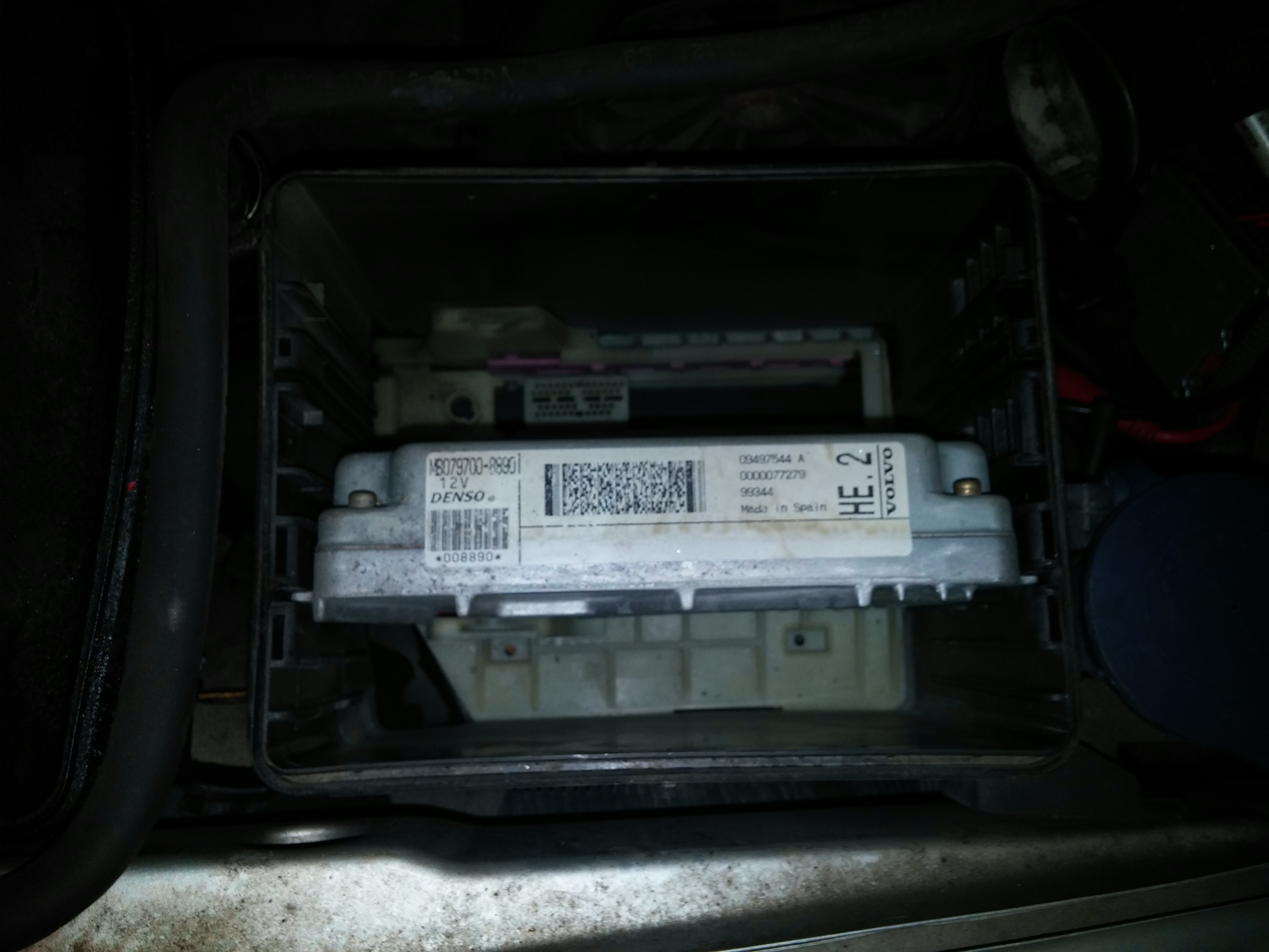

I've also tried to know if I could follow the vida instructions for IMM 321, which called for disconnecting the ecu and immobilizer. I took a photo of the ecu if its any help

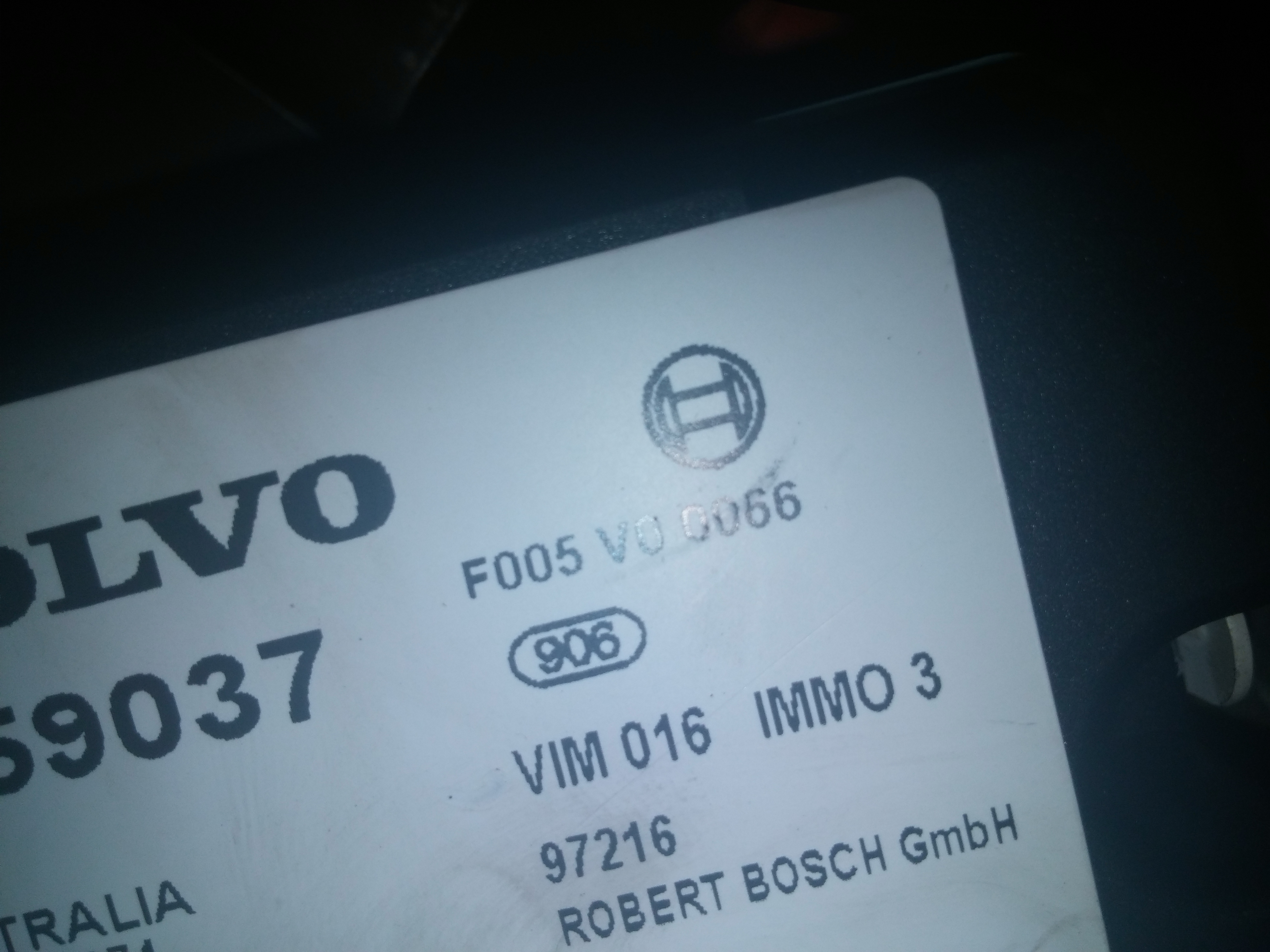

I CAN remove it, so its good. The immobilizer is harder, it seems to move but I cant see any screws (this place is tight tight tight). Anyone knows how? Also, is this the correct thing (immobilizer)?

I have the right thing, and I've found how to remove it, but I still have the electrical drain problem. No one knows what to do? :(

As for the smoking wire, I've disconnected the blue wire from whatever it is connected to and turns out the connection had oxidised and engine oil (my bad, I dont aim so good) was on it, so the water (channelled by the black plastic cable cover) trickled on it and burned the oil and gunk on the plug. There is no damage to the wires inside the black plastic thing, as far as the eyes can tell.
