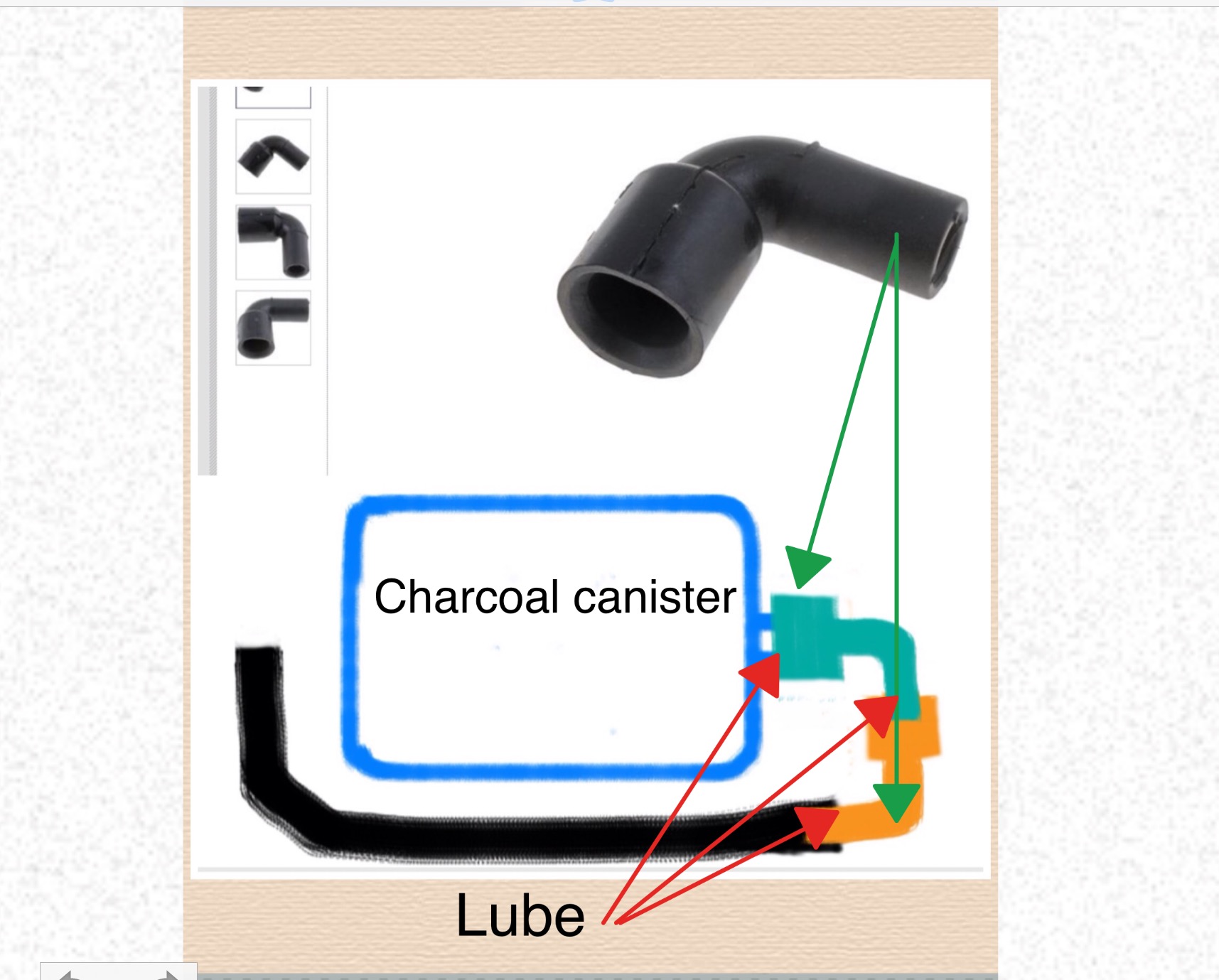

This is how I did to mine back in 2012.after researched and study,I came up with this,I got 2 PCV Valve Elbows from local auto parts store,then I lubed outside small side of elbow to make it easier to connect small end to the big end to make it look like U shape.Put the car on jack stands.Pull the J shape hose end off from charcoal canister whith a longer nose plier and lube inside a big elbow then push and wiggle it the with a grip of longer nose plier into canister,then cut partial the J hose off(My other J hose end was fine so I did not touch it) and lube the small elbow,push and wiggle it into hose,cleared the code then it done,the code never show up and passes the smog test twice.Hope this helps...
