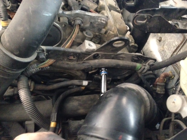

**Remove the top engine mount (four 14mm bolts, and the bolt with nut that goes horizontally through the mount). This is shown in PHOTO 1
photo 1.JPG (160.05 KiB) Viewed 776 times

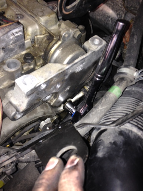

**Now you see that there is an aluminum bracket/cover bolted to the block/head which is covering the cam position sensor cover, which is covering the rear cam seal. There is a bunch of stuff (engine hoisting eye, vacuum lines, etc) bolted to that aluminum bracket/cover. Remove the bolts holding that stuff on (PHOTO 2).
photo 2.JPG (133.24 KiB) Viewed 776 times
**Now you may remove the 3 bolts holding the aluminum bracket/cover to the block/head (PHOTO 3).
photo 3.JPG (139.7 KiB) Viewed 776 times

**The aluminum bracket/cover has pins which position it on the block - after you have removed all 3 bolts, wiggle and pry it to get it off the pins. You can see the pins sticking out of the block in PHOTO 4.
photo 4.JPG (134.5 KiB) Viewed 776 times

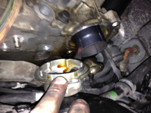

** PHOTO 5 shows the cover removed and all the oil inside.
photo 7.JPG (112.26 KiB) Viewed 776 times
PHOTO 7 is the same, different angle.

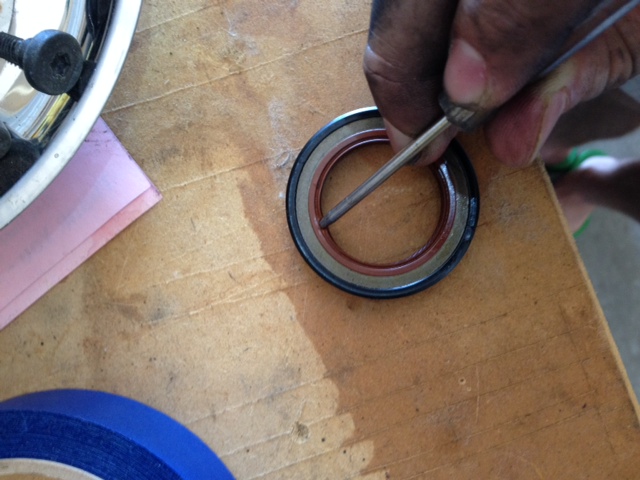

**Remove the 10mm bolt holding the cylindrical piece to the end of the cam. This exposes the seal. Mine was sticking out slightly but I couldn't grab it. I have read about drilling a screw into the seal and pulling it out with that, but I couldn't fit my drill in there, and that seemed a little excessive. Mine pried out easily. You have to know how to pry though. I jabbed a pointy "pick" in near the middle, directed outward, and pried against the camshaft. PHOTO 8 shows what I did, on my work bench. It actually came out really easily.
photo 8.JPG (115.39 KiB) Viewed 776 times
