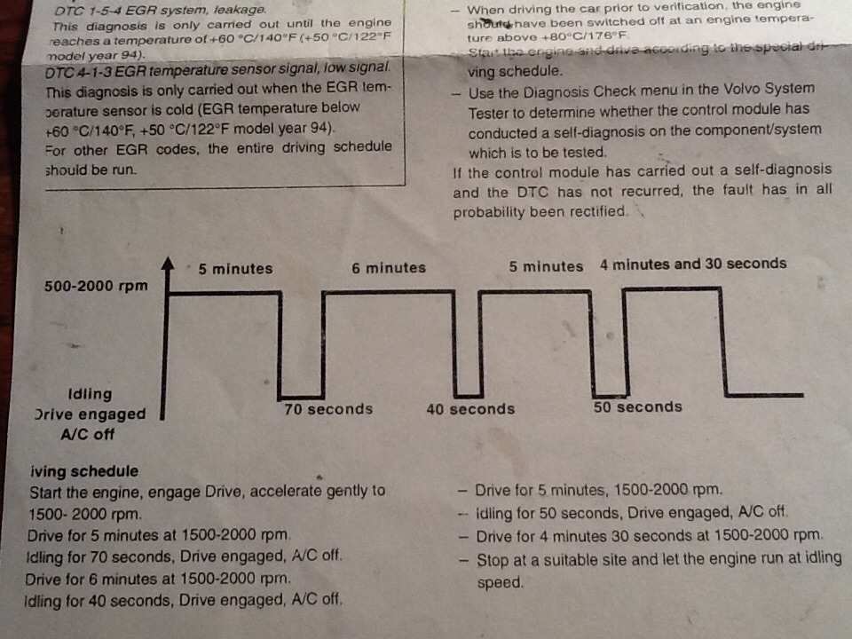

Well, the car was driven about 200 miles round trip yesterday 'like a normal person' and this morning I ran through the above referenced drive cycle which was a total pain. I took the car to the smog check station and they said that none of the monitors had been reset. He said that the above driving schedule appeared to be for EGR reset which wouldn't be applicable to this car. Is there another drive cycle that is meant to reset the following monitors: Catalyst, EVAP, Secondary Air System, and Oxygen Sensor? Misfire, Fuel System, and Component were marked 'complete.'

That drive cycle is for all monitors
Gas tank between 1/4 and 3/4 full
AC off for whole trip
CA actually issues waivers for Many models, including Volvos, for difficult "monitor ready" cars
I've driven around town a bunch, and gotten out on the free way quite a bit since my last post, and done the drive cycle twice more, and the OBDII scanner is still telling me I have five of eight monitors not ready. I'm going to give it a shot doing the cycle at least one more time, twice if I have to, and I can find a good spot to wait for two hours while the engine cools. This is the most ridiculous process. Having no idea if it's even working or not is quite aggravating. I just hope that if my efforts today don't bear fruit that my parents 500 mile drive home will run the monitors. I really hope it works today because if they can get the car smogged up here where it's registered, it'll be cheaper and doesn't require a dyno test like it does in the higher population areas.
I give up. I just got back from doing the above referenced cycle yet again, and then getting out on the freeway for several runs. Unfortunately there are no stretches of freeway near me that I can get out over 55-60 mph for longer than 12-15 minutes at a time before hitting a stop light in any direction. I still have not gotten a single monitor beyond the three continuous monitors. I beginning to think this is impossible to nail without a dyno.
