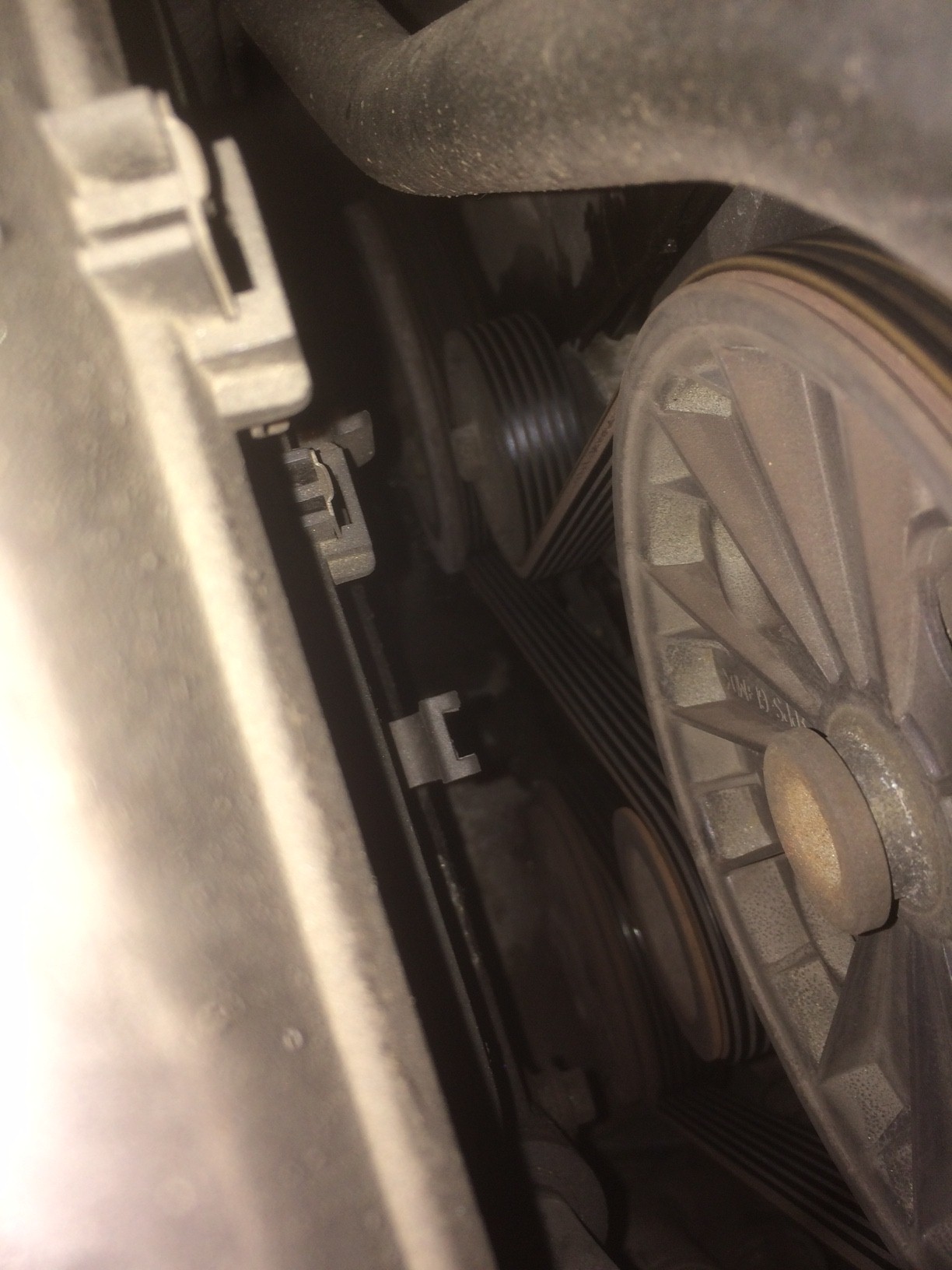

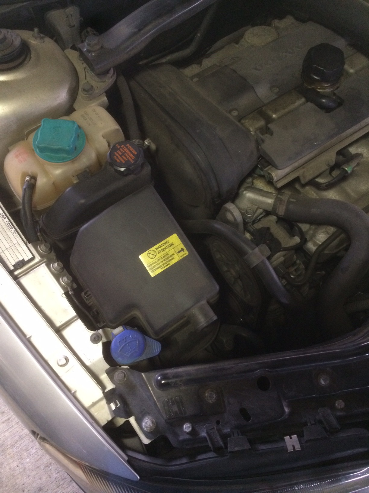

Update - oil light has been off, however today i had a quick chance to shine a light in and see if i can see oil coming out, I do see some hopefully the pictures help maybe point me in the right direction, any ideas ? or do i need to actually take some things apart?
Thanks

How long ago was the PCV service?
To me it looks like your rear cam seal might have been pushed out due to PCV pressure or is needing replacement. Hard to tell from the angle of the pictures.

it was around 95k-100k and i'm at 130, I wouldn't think the PCV should be bad?
i guess i may have it looked at or is there something i should take off to get better pics

just found this, but my leak is on the passengers side
https://www.matthewsvolvosite.com/forums ... 4480#54480

dw2001v70 wrote:just found this, but my leak is on the passengers side
Yeah, that's a FRONt cam or crankshaft seal leak.
The timing belt has to come off to get at these, so it's a 1000 USD job at a good independent. Have up you had the timing belt replaced? It was due at 105k mikes or 2011
The timing belt isn't the one you see, it's buried under the plastic covers
