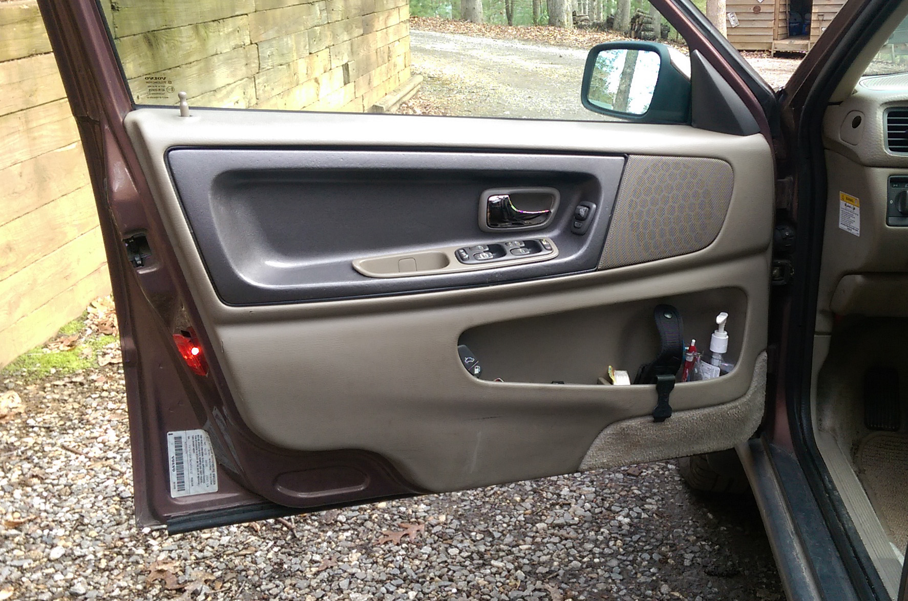

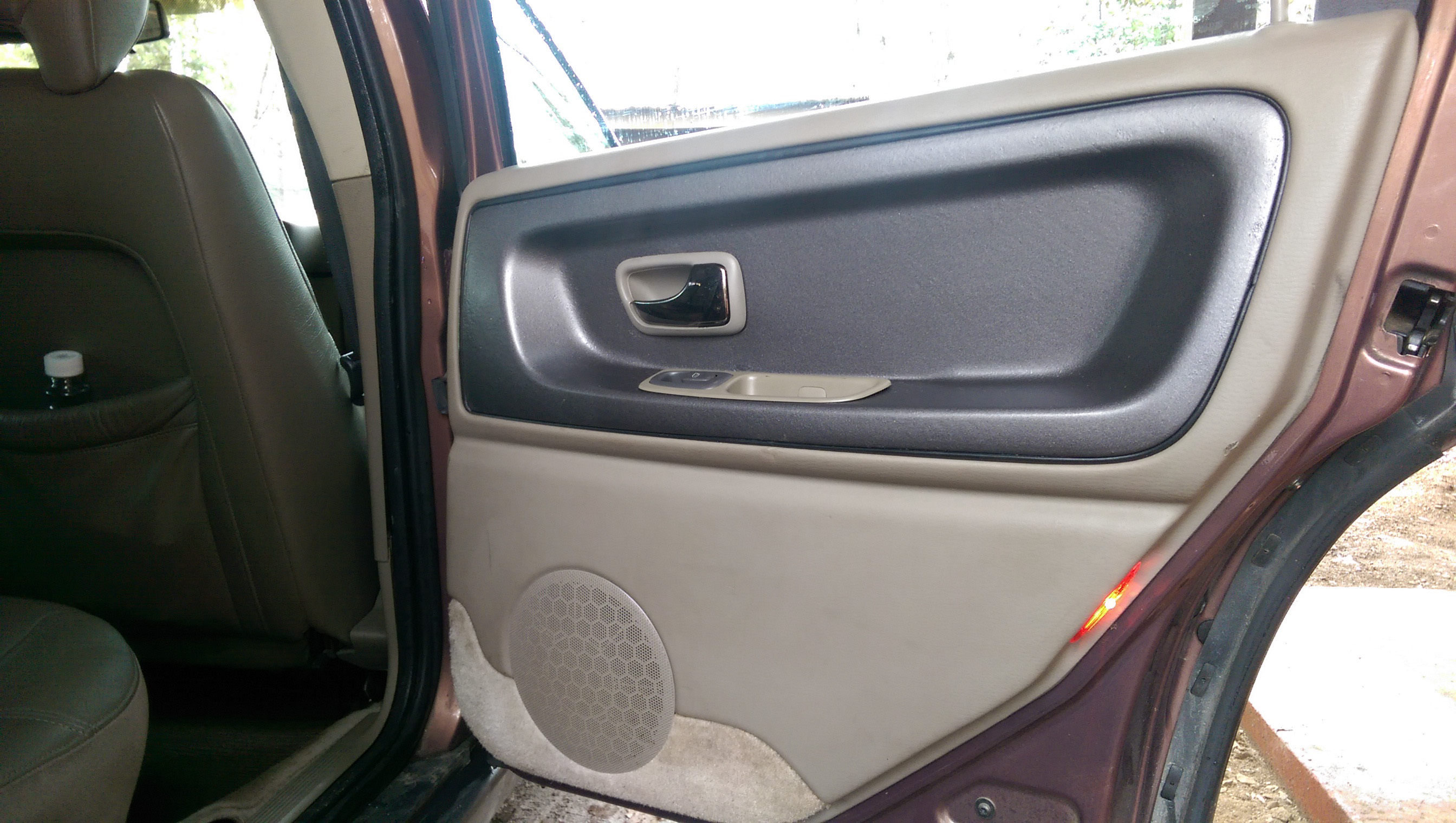

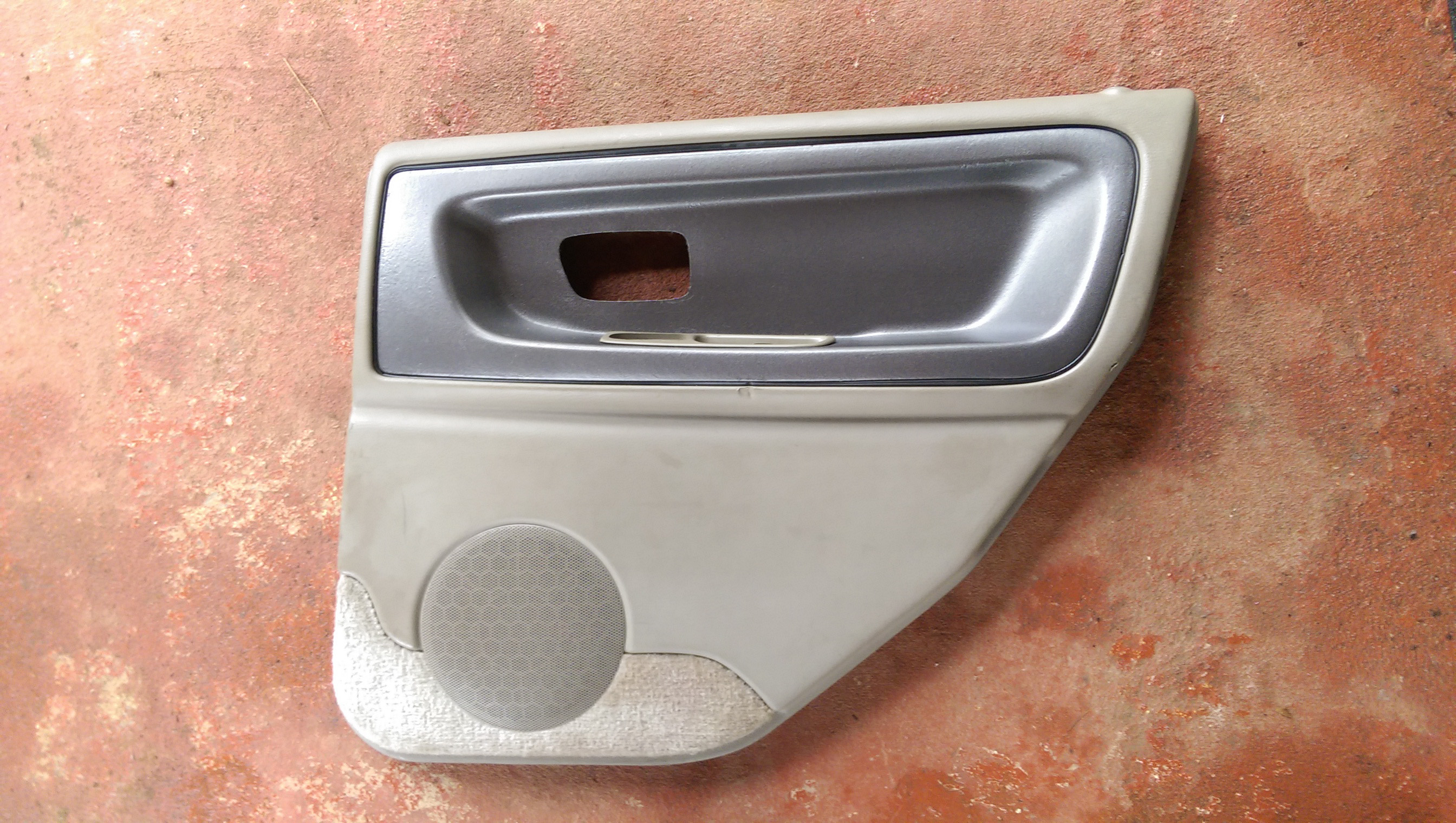

To continue getting from here
To here

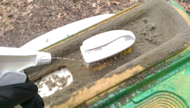

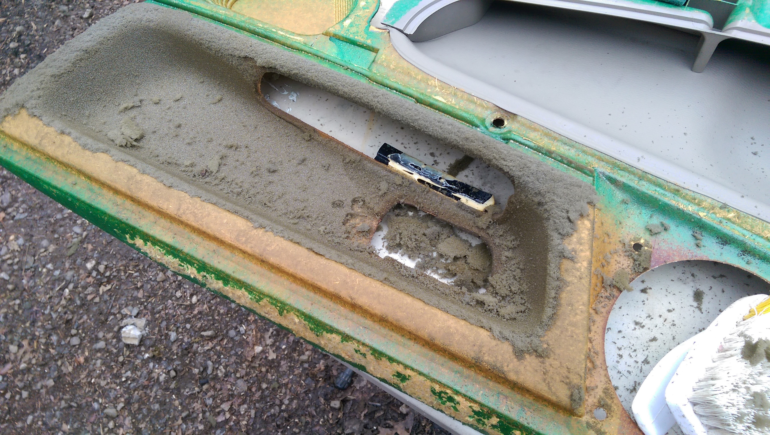

You now have to remove the foam that was "holding" the vinyl to the panel. I found the best way was to use acetone. Got a gallon and used almost all of it. It involves soaking the foam with the acetone and waiting just moments before taking a stiff brush and scrubbing away. Acetone evaporates quickly. Don't use a scraper, or anything sharp because you don't want to mark the panel.
Just keep soaking and scrubbing with the brush until most of the foam is gone.

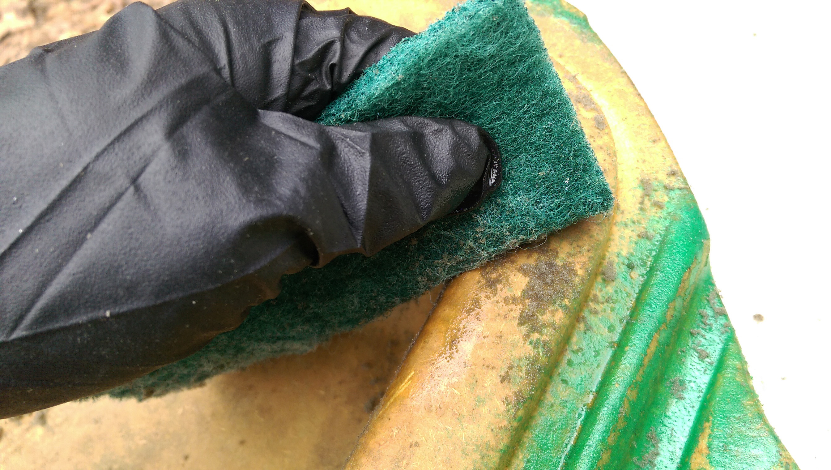

To remove the rest of the finer foam residue use a 3M scrubbing pad. Pay attention to the outside edge too.
Take time to lightly sand the surface to get the fibers that are pulled up from scrubbing. Dry the panel over night or in the sun before going further. You should have a nice clean surface to work with now.

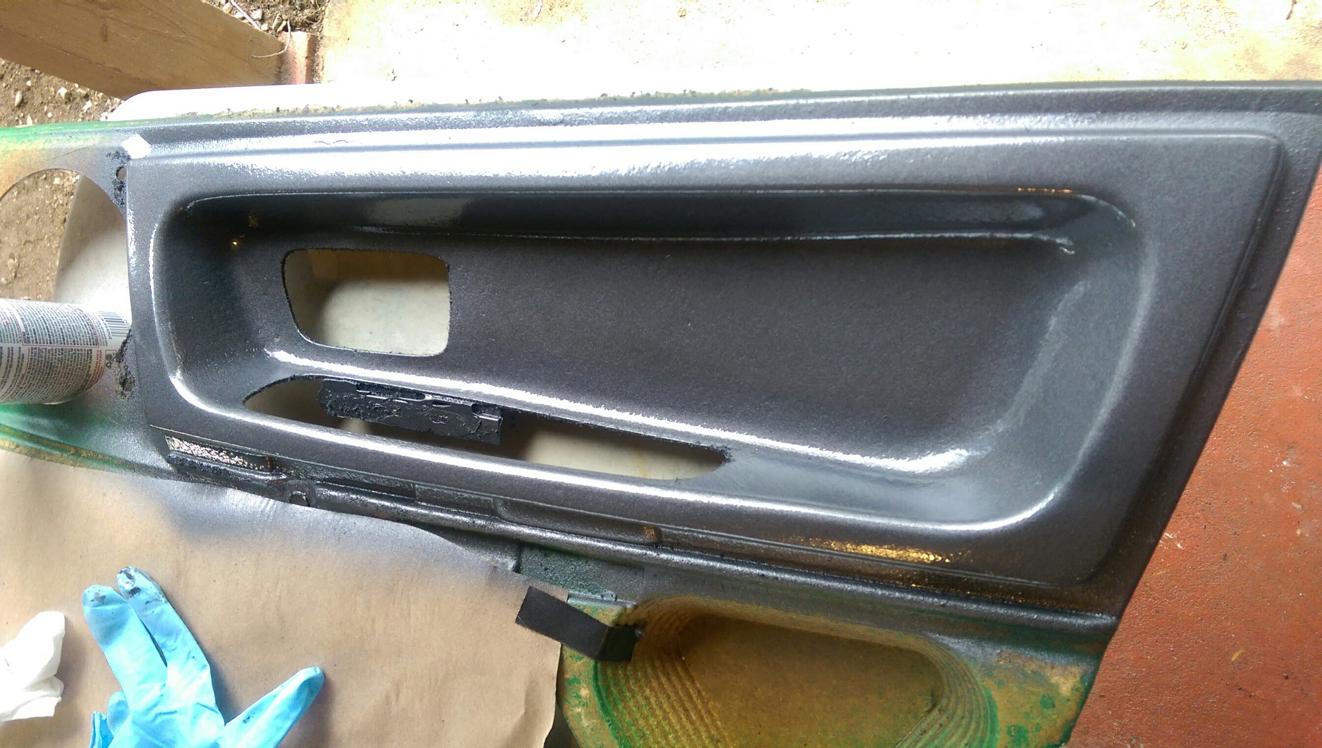

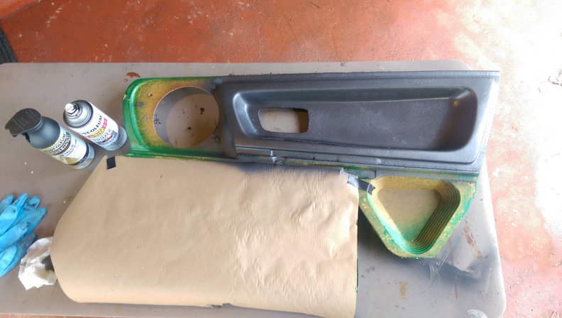

From here you can go several routes. Re-Vinyl, Cloth, Leather, Shag carpet. Its your preference. Mine was to paint it a similar color to the grey plastic trim interior. I really like grey. I covered the panel areas I did not want to paint. Coated it in primer, sanded, another layer of primer and then two coats of grey fleck paint.
Two coats of clear coat and let dry for a few hours.

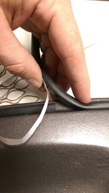

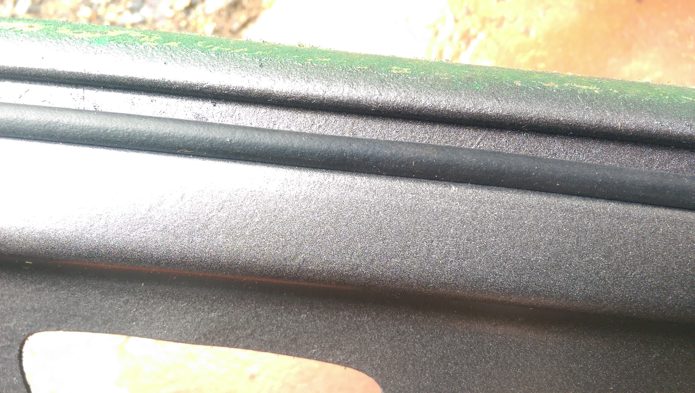

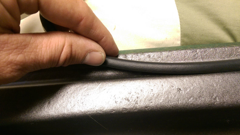

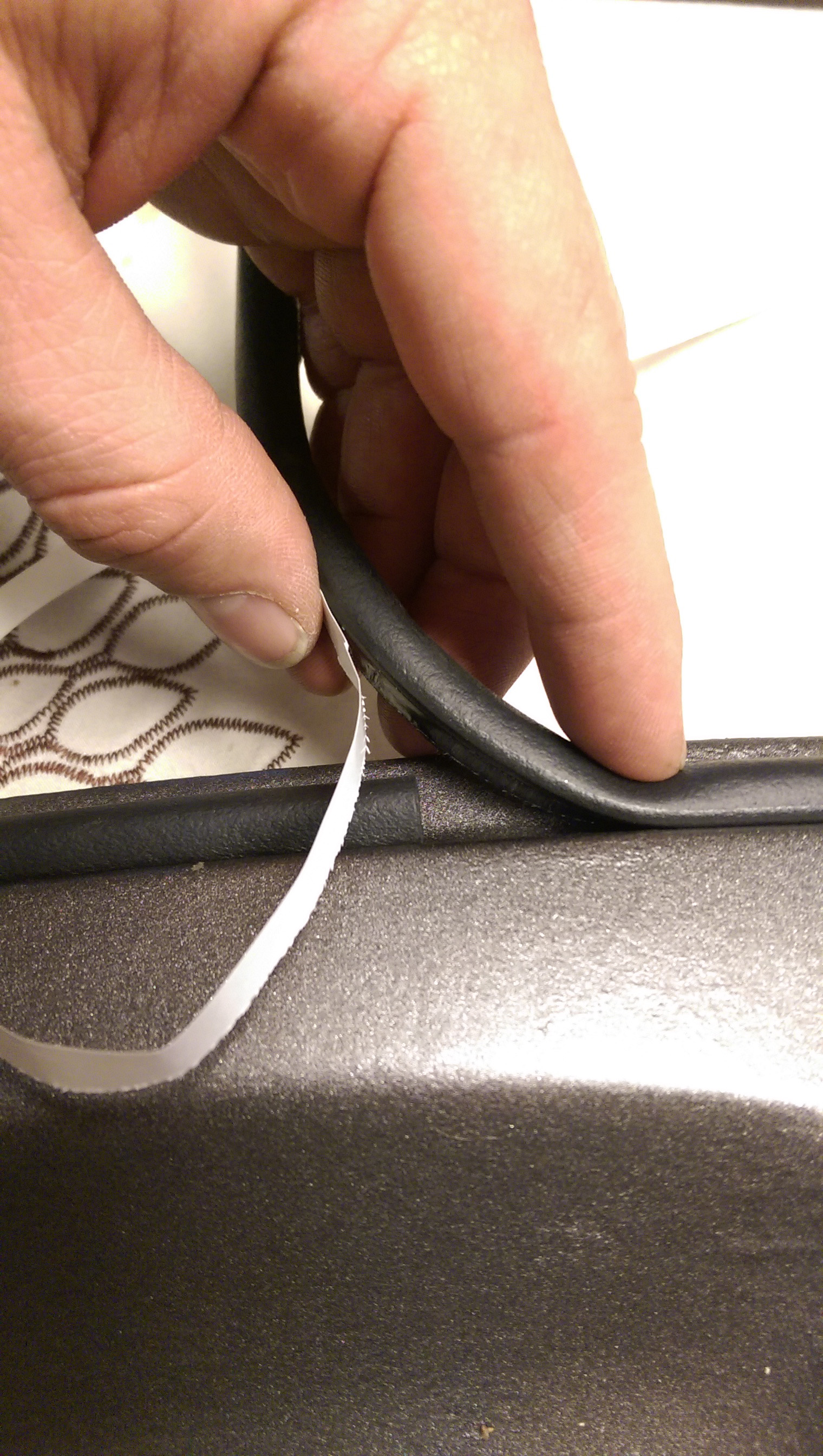

Using this method of restoration/refit I ran into a problem I did not plan on. The original vinyl padding was about 1/4 inch thick. When reassembled there was a space between the front half and the back half. Not ideal because air, road noise and light came through. My solution was "D" foam rubber strips. Like this https://www.amazon.com/Dealglad%C2%AE-Se ... ndow+black
I bought mine at Home Depot.
This part is one you must take great care in doing right. I started the strip at the center of the rear portion closest to the door latch. This way I would not see a seam while sitting in the car.
Make sure your hands are clean, the panel surface is clean and that you press the D foam to the panel firmly. Follow the contour of the panel, its not a straight line. Don't get oil from your fingers on the surface or the adhesive will release months later.
Once you have wrapped the foam all the way around where the vinyl used to be make sure you go back and press the D Foam onto the panel, checking fit and finish.

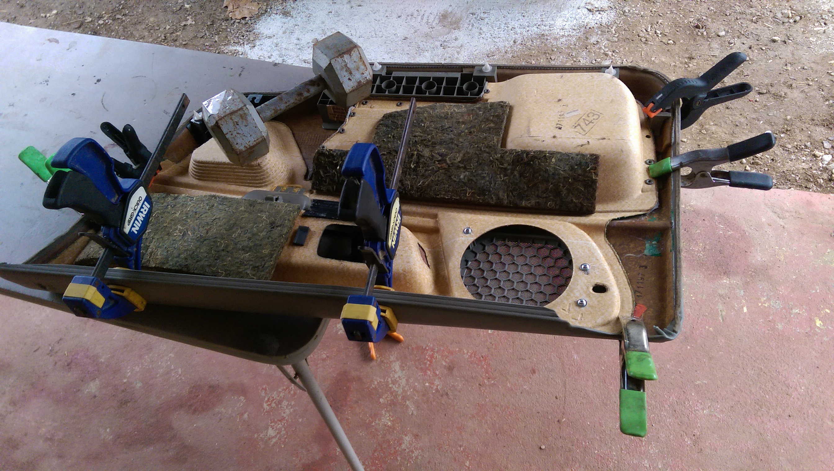

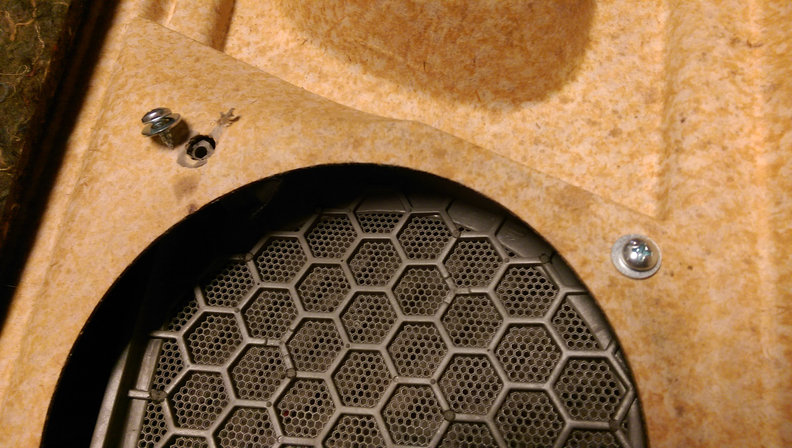

Now reattach the speaker grill. # 10 washers and # 10 3/8" screws were used. I drilled out the old plastic welds on the back of the speaker grill. Don't drill completely through. Make sure you use a bit that is close to the same size as the screw because the plastic is brittle and will split if the screw has to dig in too much. Hand tighten only.
Now to test fit and check for gaps.

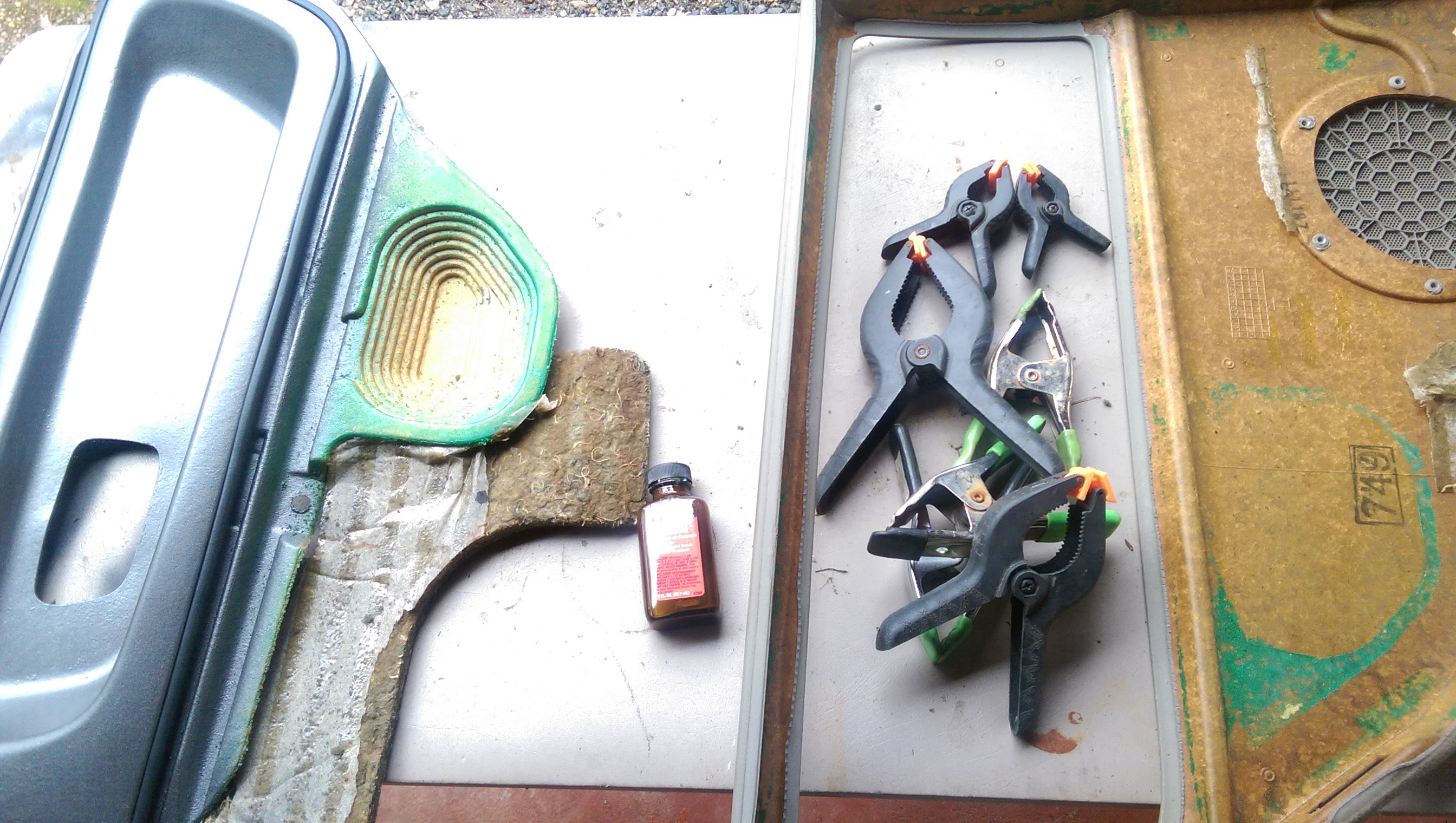

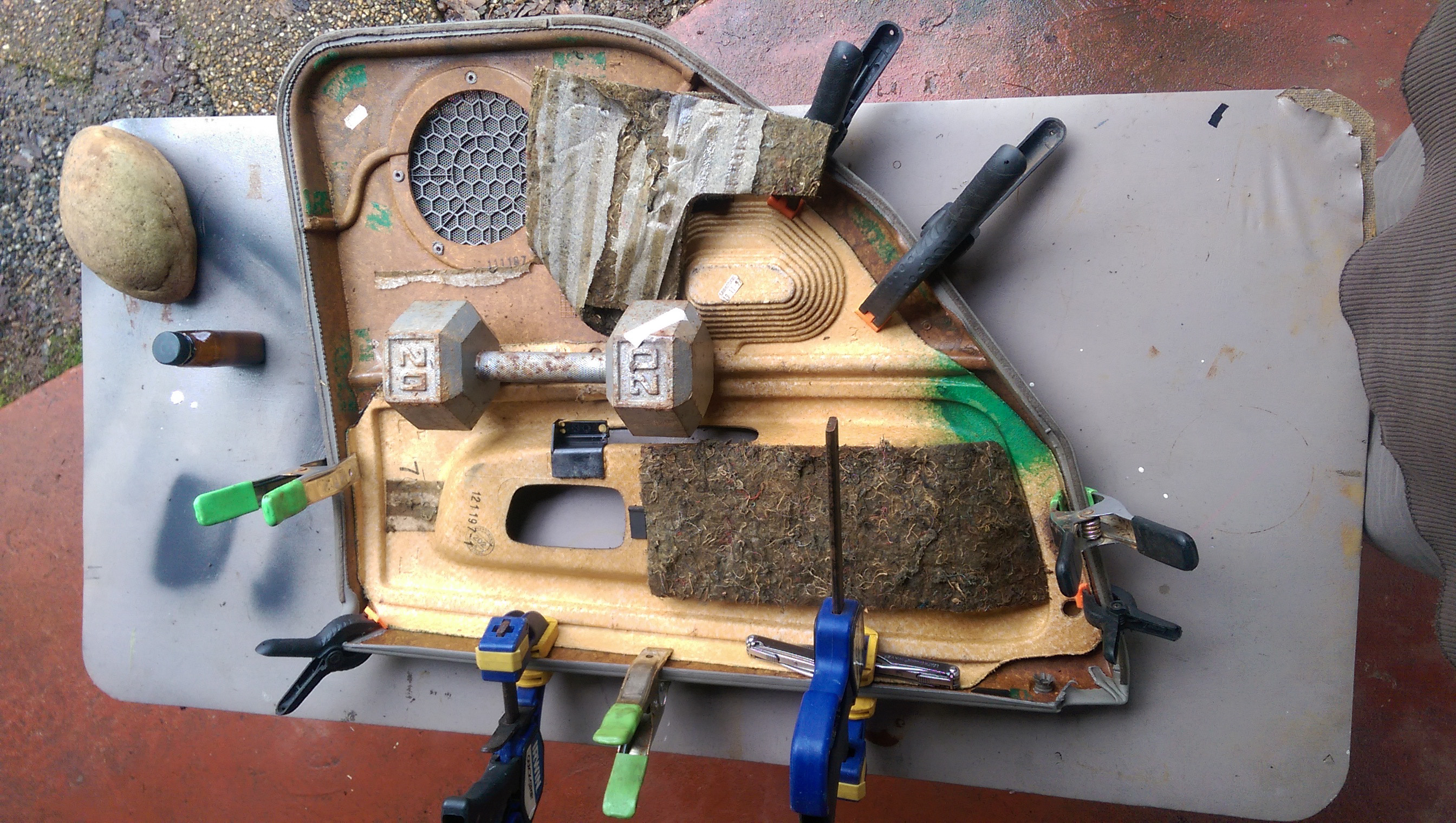

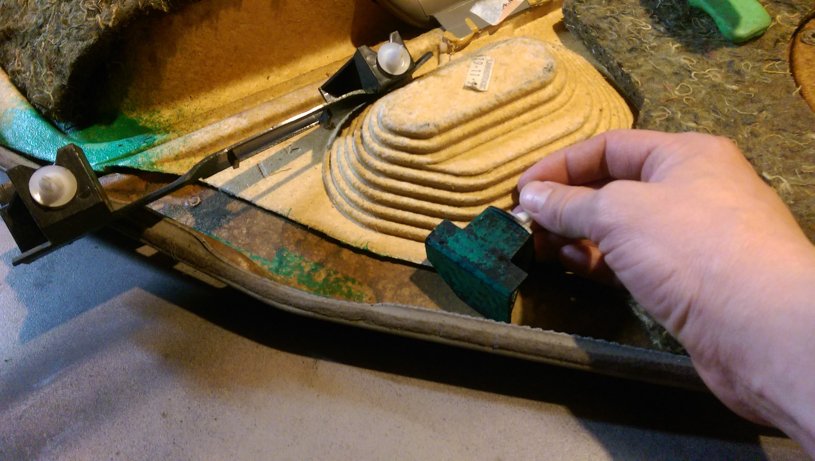

The hardest part is gluing it all back together. I used contact cement because it has high temperature resistance, bonds most anything, and can dry without exposure to air. There may be better products out there so use what you feel will work best(Not Liquid Nails).

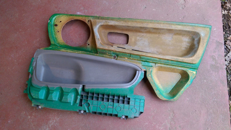

Do a dry run of putting it all back together to get a feel for what needs to be done. Contact cement is not easy, if not impossible, to reset. Notice where the parts touch and where the green factory glue is. Once you are comfortable, put together the front half and back half first. Apply glue to the green areas and wait for the cement to set. Put the parts together and clamp firmly. This process is many minutes of gluing and waiting. I did mine in cold March and the glue took longer to dry, outside.

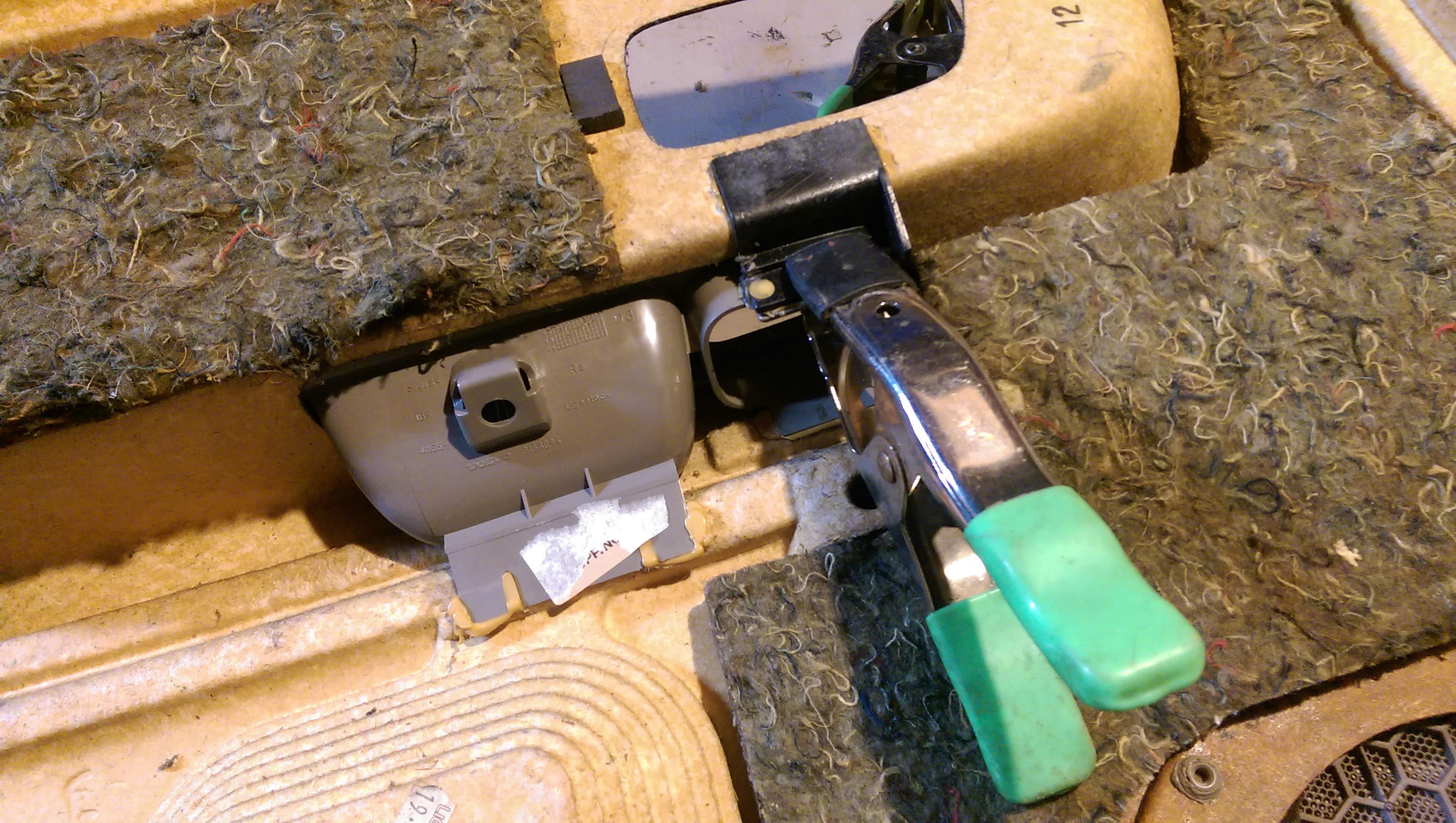

The area hardest to get glued was the seam below the door handle. Lots of creative clamping there.

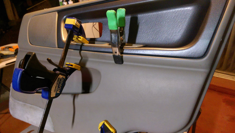

Glue and clamp the Black door panel clips.

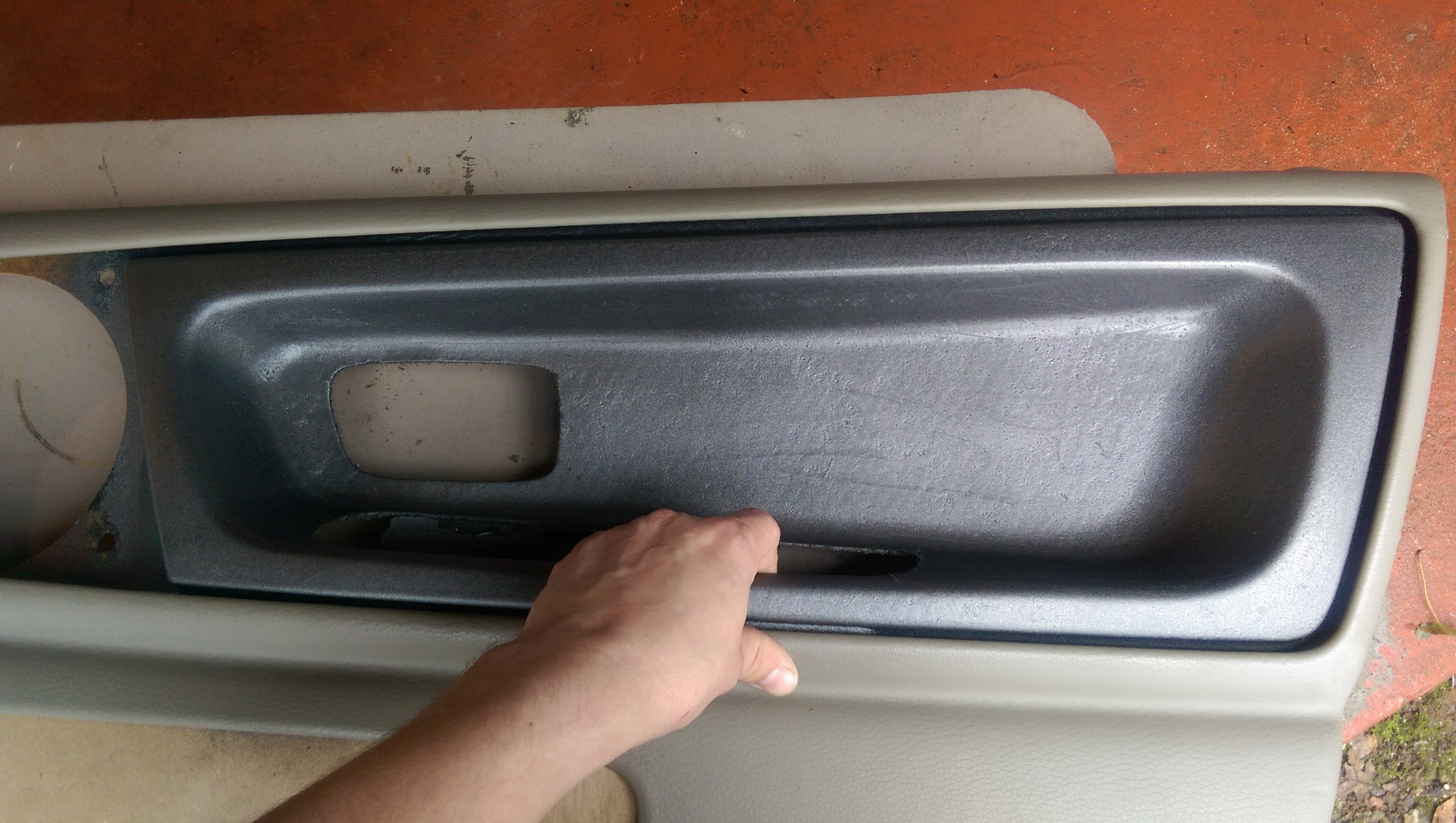

Without the foam+vinyl adding 1/4" to the door, the plastic door handle will seat itself lower in the panel and you will have trial and error here. Liberal amounts of glue used here.

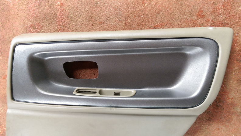

A finished product took a day for each panel. Mostly due to the cold weather.
This was a trial and error project and improvements can be made.

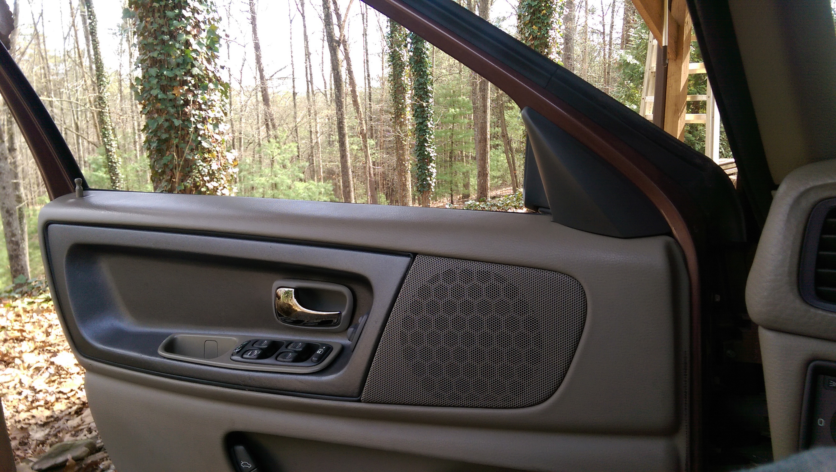

I am happy, I have a place for my elbow now!
