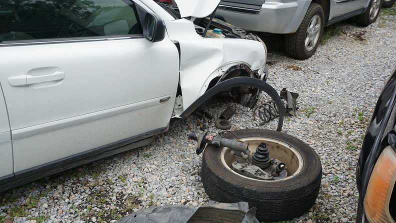

My daughter wrecked her 05 XC90 V8 back in July. Had full coverage and they totalled it out due to estimated $8900 repair bill. All this wreck did was damaged front right side of front clip and right side fender destroyed. Right wheel came off too along with everything attached to it. Half shaft pulled loose at joint, strut snapped at top mount and ball joint popped out along with ball in inner tie rod. Brake line and abs wire severed.

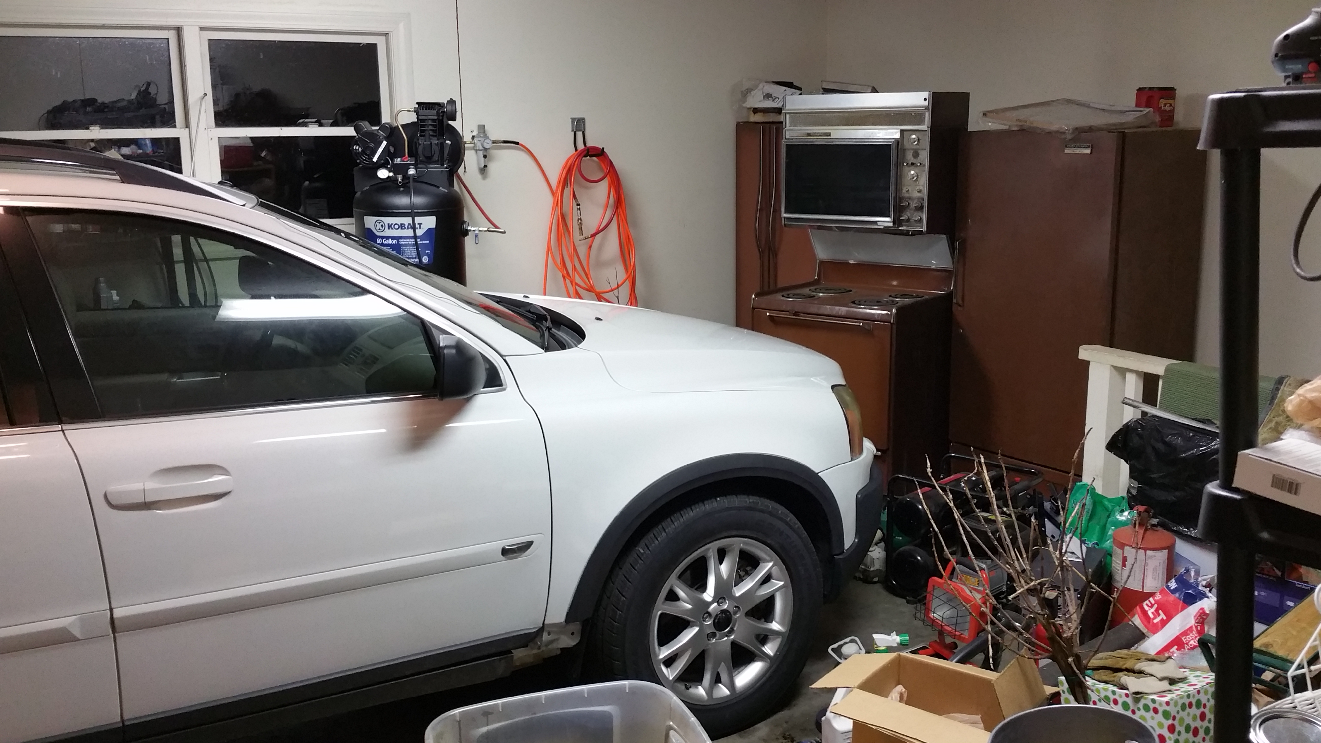

I was able to buy it back from insurance for $1200 after verifying no frame damage. I did all mechanical work on right side myself with used and new parts where needed. Spindle and drives haft used and wheel used. All other parts were new off Amazon or other online retailers. I had a body guy install fender and fix tweak in passenger door and repair bumper and paint for $450. Decent enough job. Today this is where I am with it.
I am pleased with it and it drives pretty good and is aligned to spec. I have noticed a small leak of oil thru weep hole where engine and tranny connect. I have oil dye coming tomorrow to rule out power steering fluid leaking down valley of motor and out. I will add due to engine oil and if in a week no fluorescent markings it has to be steering fluid. I was down on it prior to wreck. Not pink so don't believe it is transmission fluid. I will be checking level of transmission fluid tomorrow with dice clone. I had fluid flushed by independent volvo shop using cooler lines about 10k miles prior to wreck. Debating doing a drain and refill tomorrow or just leave alone and flush again in 15k miles. I used Mobil 3309 fluid for flush by indie and if I do drain and refill would top with Toyota T IV.
