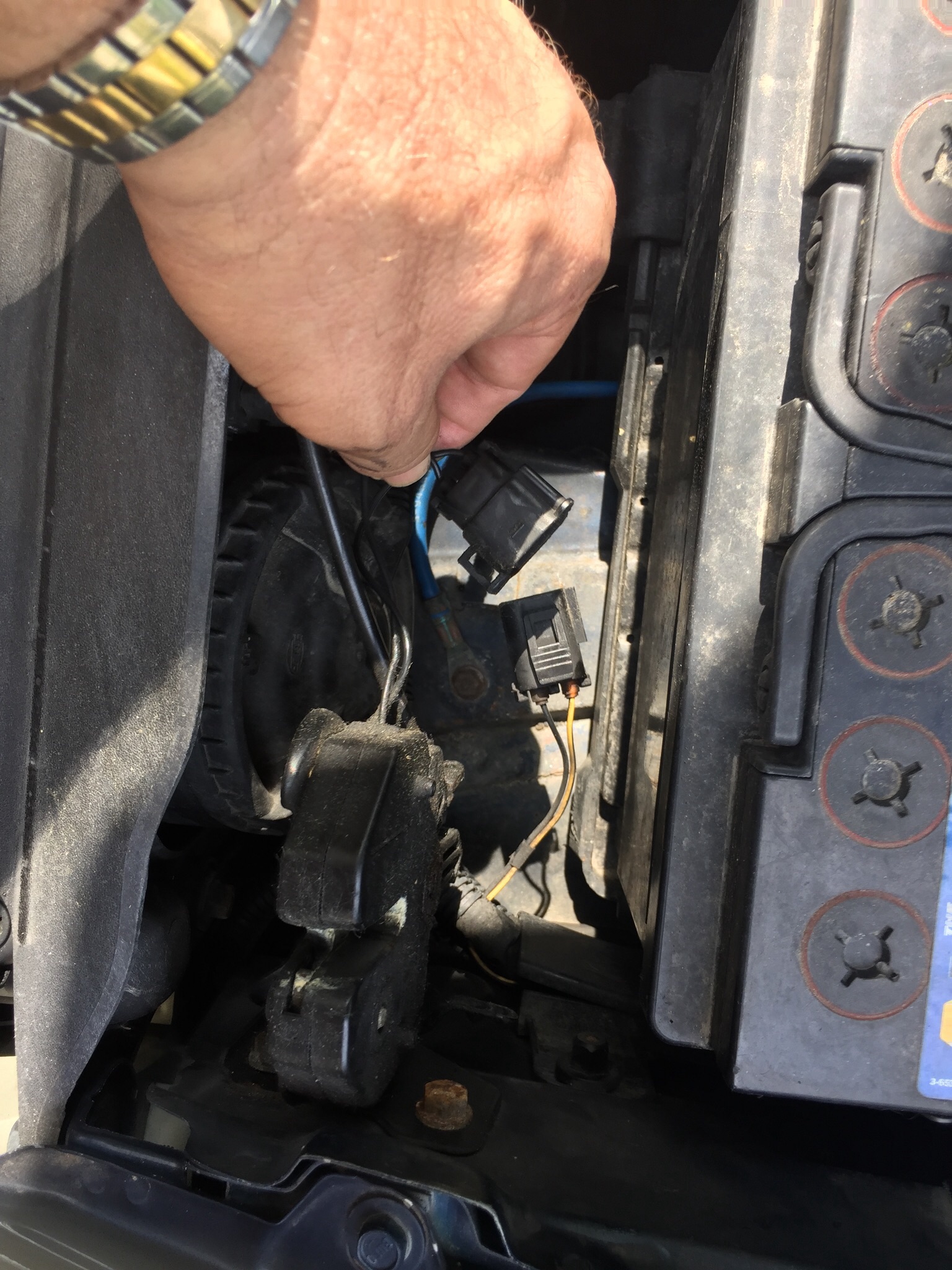

I'm also going to guess its the hood alarm.
You can unplug the sick cow alarm under the hood...it looks like a small alien space craft mounted up in the cowl tight below the windshield and stop the noise at least. If you unplug the hood switch that will stop the alarm from setting when you lock the doors.
I think. I leVe my keys in the car so I don't know a lot about alarms

I don't think she is having trouble running, the key is canceling the alarm ok. I was thinking you could fool the alarm into not setting by unplugging the hood switch, then lock the rest of the doors

I tried to bypass my alarm by disconnecting the hood switch but I couldn't get a positive alarm to confirm. Then I Remembered the alarm takes some time to set, do I did confirm it worked later. Try disconnect this connector and then locking the car to see if it alarms
