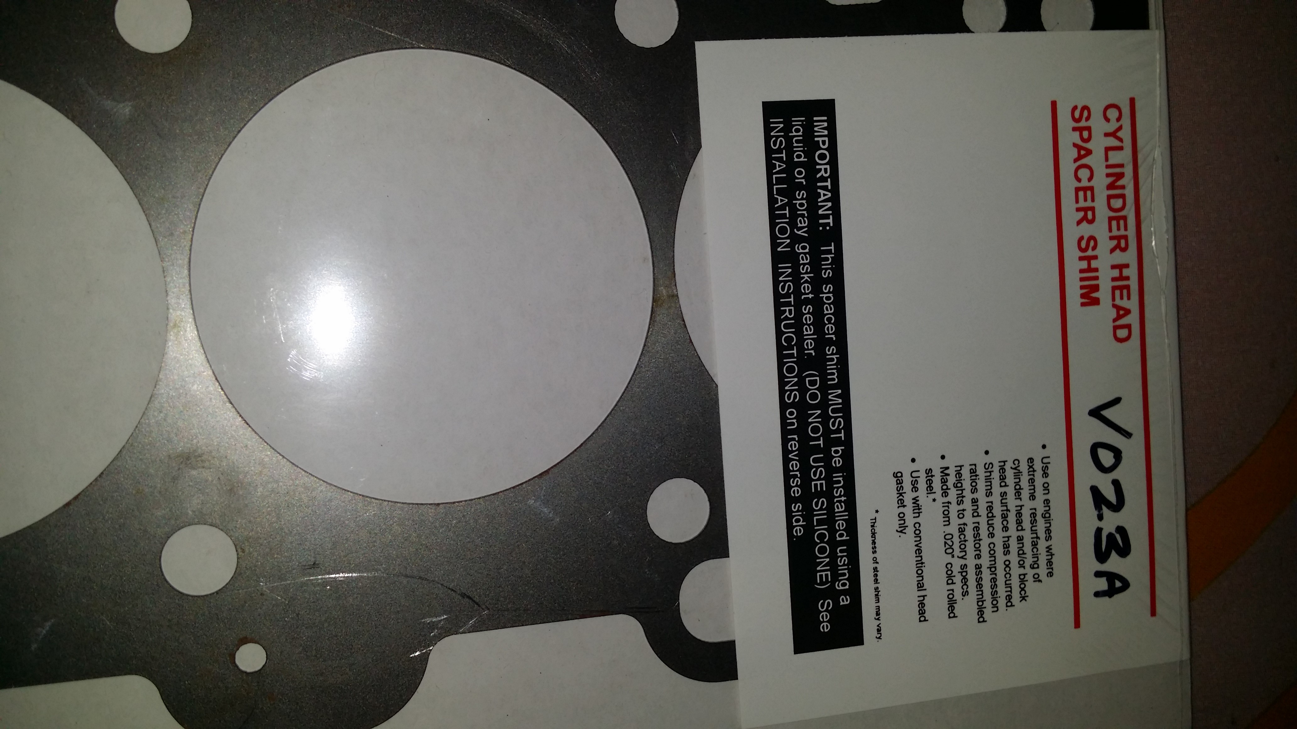

'94 854Turbo Resurfaced Head came back from shop with a shim
Has anyone heard of using a shim to give more clearance? I don't know if I just found a shop that doesn't do Volvo's or that just screwed up on my head at my expense. They said that the machinist recommended that I use a shim with the resurfaced head. I don't know if it was for more clearance with the valves. But then I think it was the owner said that I shouldn't put anything between the block and the shim just between the head and the gasket. I thought that sounded weird and when I asked if I shouldn't use the anerobic sealant between all the surfaces he said no you don't need to use that stuff just the regular stuff would be fine. I should have called the Indy shop in Grants Pass, ReVolvo West and asked him who he uses in town for machine work. Hindsite being 20/20 and all. Any advice guys. I split this off of the original post from August about Alot of Codes. My, how much learn and how much there still is to learn.

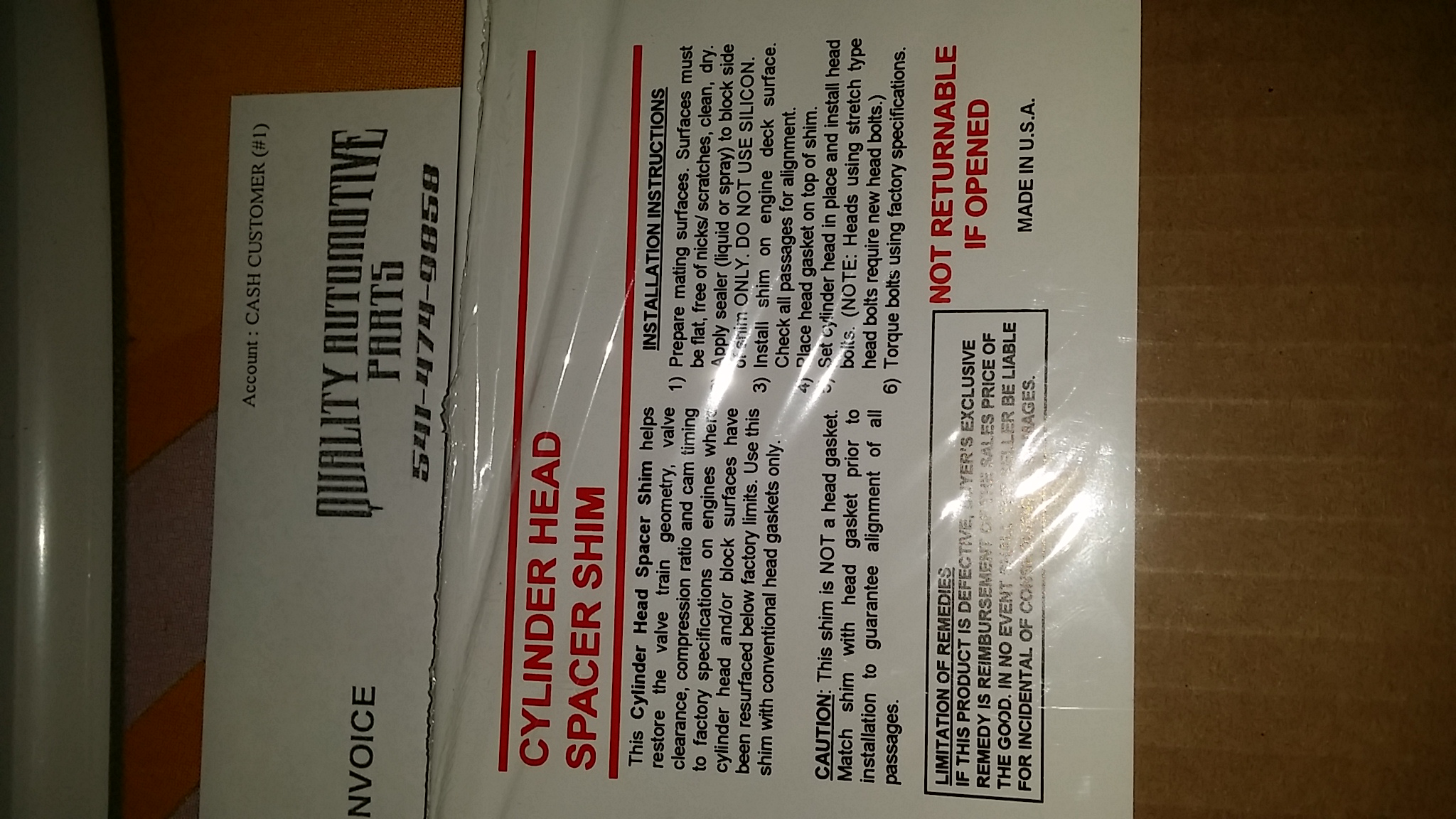

Here's what is on the tag that was attached to my head:
48.5mm+-.4mm
1.9095+-(.)016
1.565-1.575 I
1.565-1.575 E
1.560-.565
So it shows that it is from .020 cold rolled steal. Hopefully the pictures of the shim I uploaded show up.

I'll call my local indy shop on Monday about what they think about the shim and take it in for them to get a look at it.
Then I'm probably just going to have use the shim.
So here would be my game plan.
The instructions that came with the shim say "to apply liquid or spray sealer to block side.'
So I'm going to use the anaerobic sealant on the block.
Lay the shim on that.
Should I spray the head gasket on both sides with the Permatex Copper Spray like the instructions on TracyTrueSoaps shows?
Thanks, Shannon
Thanks, Shannon
