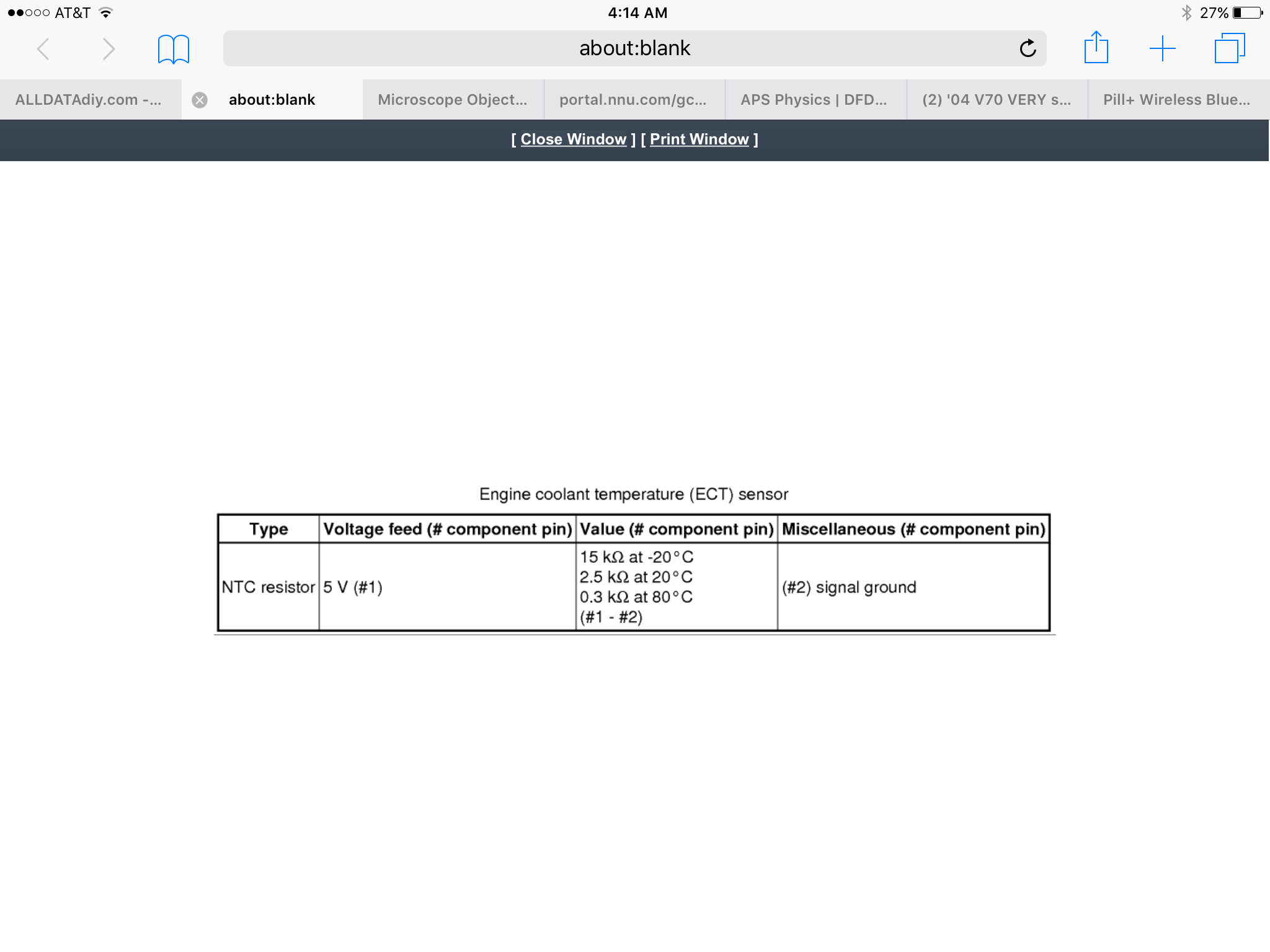

Check the ECT yo see if the resistance is right for ambient temperature. I'll try to find the table. I'm guessing you aren't getting cold start injection.

Is it possible for the ECT to be giving the proper reading on the temp gauge, but still be malfunctioning regarding cold start injection?

Yes. The gauge is very nonlinear so it won't show many errors
