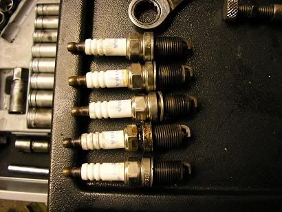

i'm pretty sure its the headgasket, i had a look at the sparks and #2 is burning a lot hotter than the rest... damn...
Anyway i ordered a block tester to see if there is CO in the coolant and i suspect there is. If so the head is coming off. If it was anybody elses car i would have had the head off already but i treat this car so well, a burnt valve i could understand but a headgasket... go figure...
