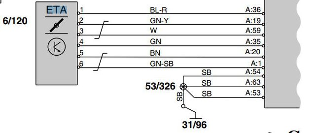

02 v70 turbo...Doing an engine overhaul and during tear down process broke the ETM connector. Got connector replaced from dealership... I coulda sworn I swapped out the right wire in the right slot in the rebuild process... But at any rate when I start the car its a very rough Idle and I have no power, as in zero...not even limp mode.
Any diagram of that connector showing the wire color and position would be greatly appreciated, as well as any other ideas for my, "zero power" capabilities.

He has a 2002 with an ETA, not the ETM.

Sorry, I could have sworn that he specifically requested the ETM connections and connector layout. :)
But as Jimmy merely criticized, and did not attempt to provide the ETA diagrams, here they are:

Thanks for all that guys!! I did it right the first time. However upon starting the engine, its a rough idle... Also the Accelerator is responsive, so no more "zero power" issue! Any ideas for possibilities of rough idle, other than the timing being off?
