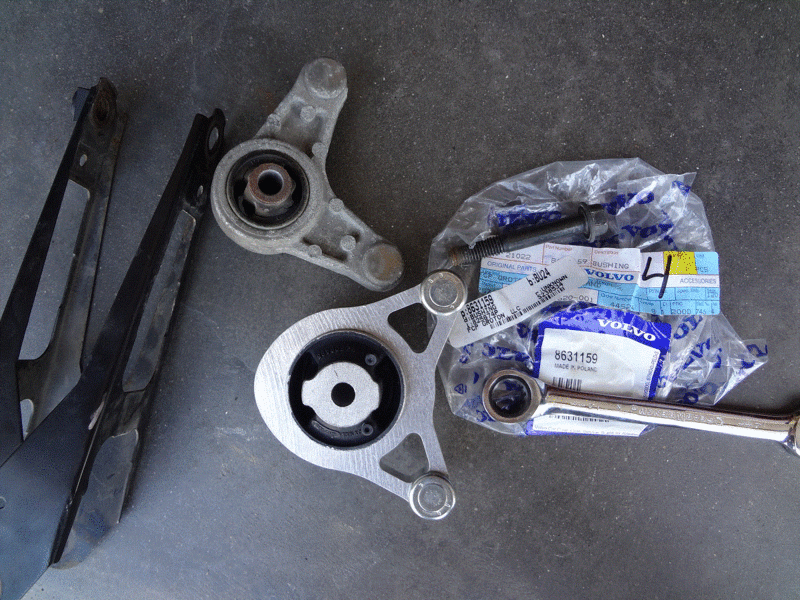

R&R'd the upper and lower torque mounts today with Volvo OEM. MacGyver'd a upper torque bushing press out of materials around the homestead. Worked great, pressing the original one out was a lot harder than pressing the new one in. Can definitely tell difference in transmission shifting smoothness with the new mount installed. The original bushing was about 2/3 torn through, my guess is it would have broke in a week or two, even though I was driving like a proverbial old lady (pained me to get passed by a new Audi the other morning).

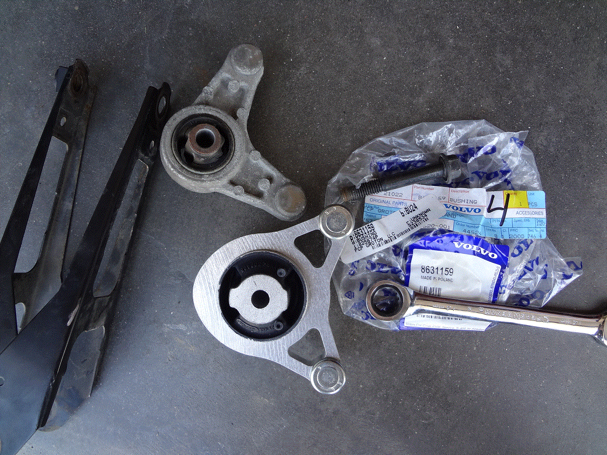

Note the difference in OEM and new Volvo OEM (Made in Poland) firewall upper torque mount.

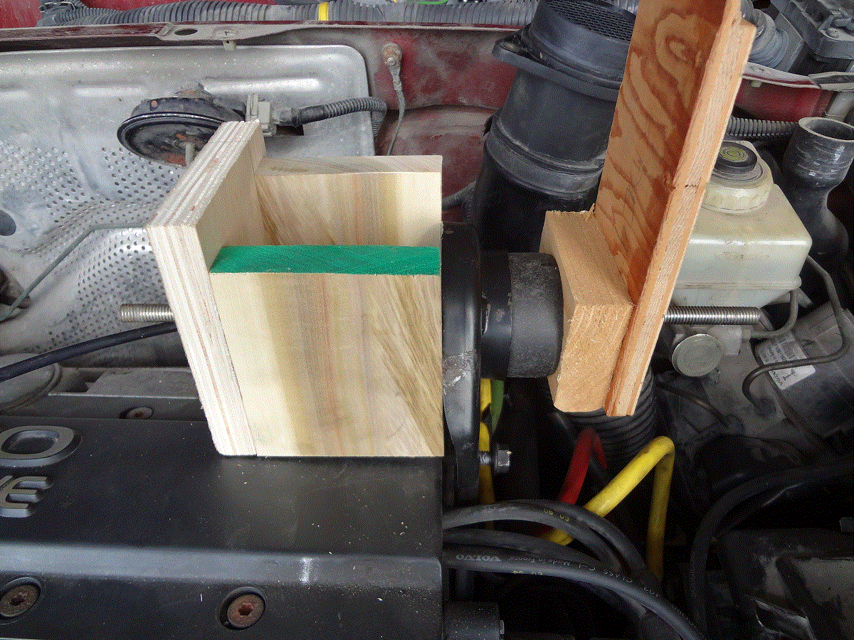

My interpretation of a torque mount bushing press, installing the new bushing. If anyone wants it I'll mail it to them; you'll have to supply the threaded rod. Longest part of the project was designing and building the busing press. The tall piece of plywood was so I has something to hold onto, it really wasn't needed. Note the small black line on the bushing indicating "arrow pointing up is here".

14 stars on the homemade press, I like it.

I agree. Great looking press that we can all fabricate out of pieces of wood we all have lying around.
