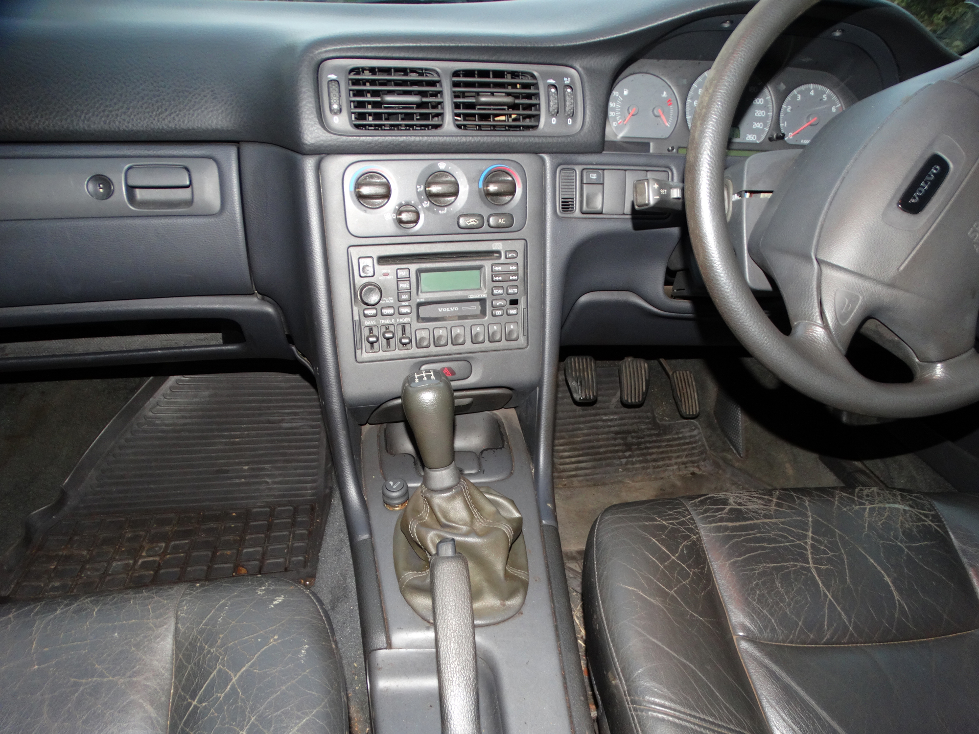

Ive bought myself a parts car, manuals are getting very hard to find here so I snapped this up quick smart online without test driving it. The seller said he hadn't driven it for 12 months but it drove fine then.
So today I tested it and couldn't engage any of the gears, clutch feels okay and the external slave is moving the fork. funny thing is let the car roll abit and it goes into gear or turn the motor off and it goes into gear but with engine running and at a standstill no gears engage.
On a flat surface in gear and clutch pedal pressed it doesn't roll even at 3-4k rpm
Clutch bad or gearbox faulty??
1998 V70 M56 parts car question
