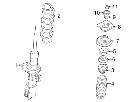

When I look at the top side of the front struts under the bonnet, and jack the car up, when the wheels come off the ground, I see 1/4" movement on the nut and washer that makes me wonder what's going on.
I saw this last week and bought new reinforced spring mounts and top bearings thinking all would be snug after fitting but it aint so
Also, looking at diagrams to check parts order, I see that the washer that goes after the bump stop looks like a plain washer with a rolled edge. Mine have a Bakalite like insert tha looks like it had a flange on it that has busted away. Anyone have a clue what's going on with this. IPD boys didn't know nuffin about such an insert.

Oh wowsa! I though from the pics you were doing an evaporator replacement. I have no idea of the epoxy will hold but it's worth a try. I recall a similar operation a few years ago that was successful. There's a diagram of all the strut part here (hopefully it will help!): http://www.tascaparts.com/auto-parts/19 ... nents-scat
Volvo part numbers for each piece that is numbered is in the link provided.

Thanks MiJ. My mystery part in Bakalite is #6 which when referenced on their cut sheets, doesn't show as available !! So, I suppose we just don't need it.

Road tested and shocks now don't clunk. Very happy with that, just revealed how bad the shocks are !! Oh well, now I know I can get new shocks done in a relaxed day.
